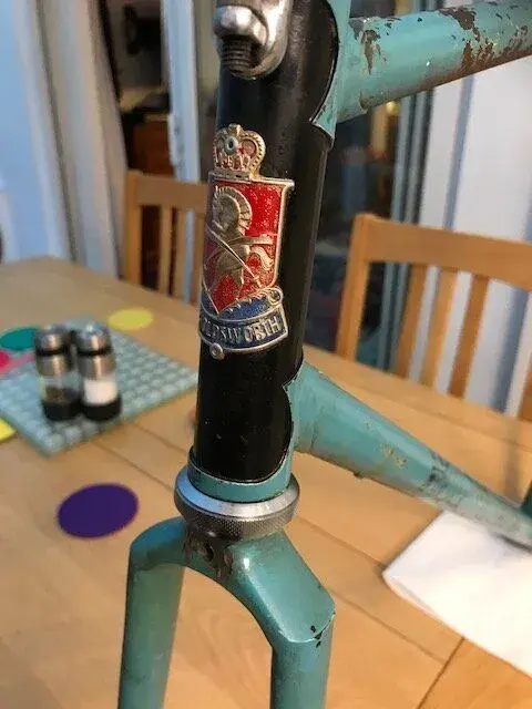

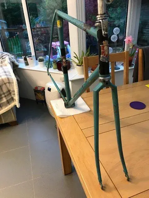

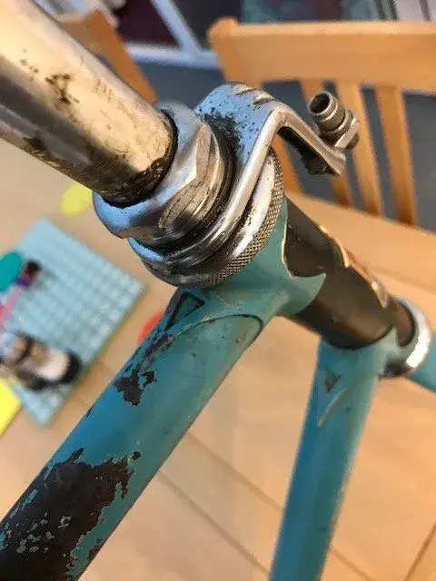

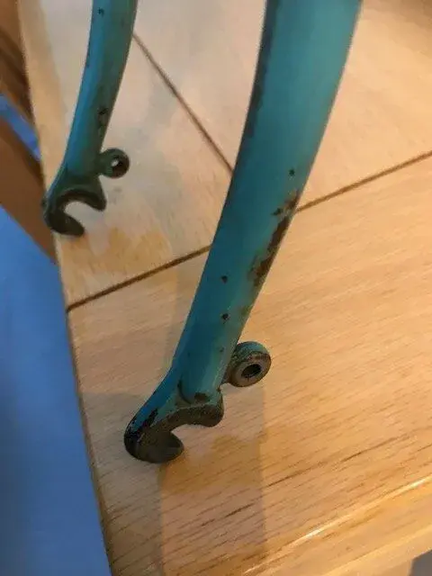

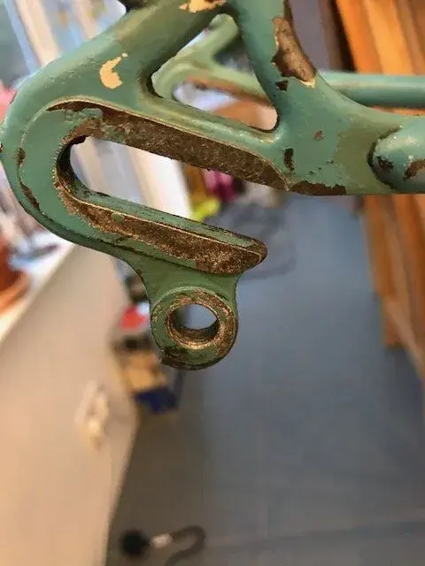

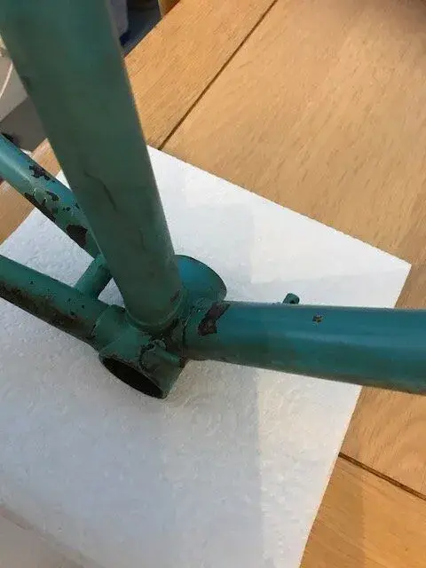

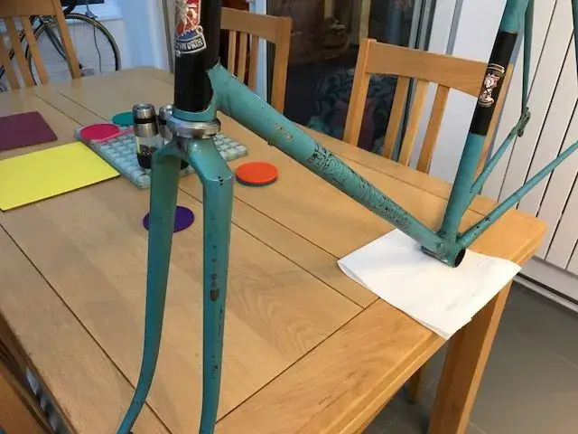

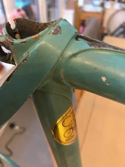

Good evening all,
Just acquired this frame set yesterday so looking for some help in identifying it.
It seems to have some similarities to the discussion around wobler's flamboyant green and white frame.
The serial number on the bottom bracket is 74770. It is stamped into the front of the BB just to left of centre on the drive side. The punches are quite fine.
The rear stays are 5/8" at the rear bridge joint and at the bottom of the wrap over.
Unlike wobler's the lugs are pierced.
The brazed fittings are button under down tube, cable guide for rear derallieur and single fitting for rear cable outer, single cable guide on down tube for cable outer to front derallieur.
The drop-outs are Campag.
Head badge looks undisturbed and no sign of any lug lining.
The forks have the sloping crown but I can't yet get them out due to sieved stem. It twists with som leverage but will not move in or out!!!
Any assistance in identifying greatly appreciated.
Having some problem loading pics so will try to reduce size!
Pictures

More pictures
