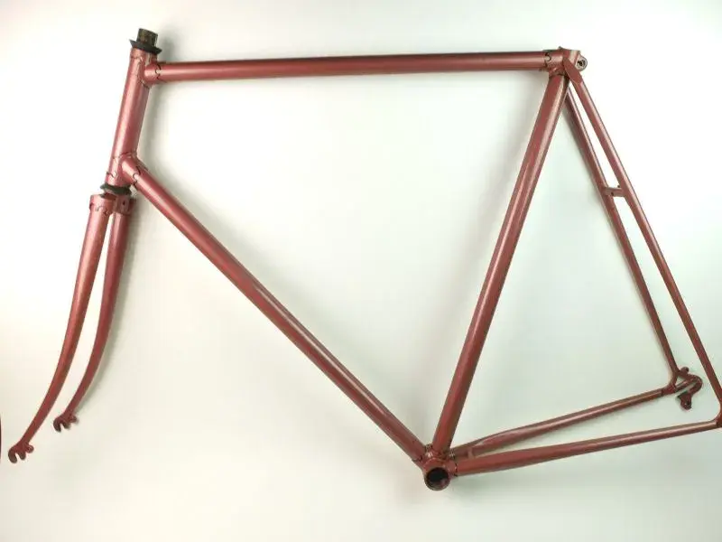

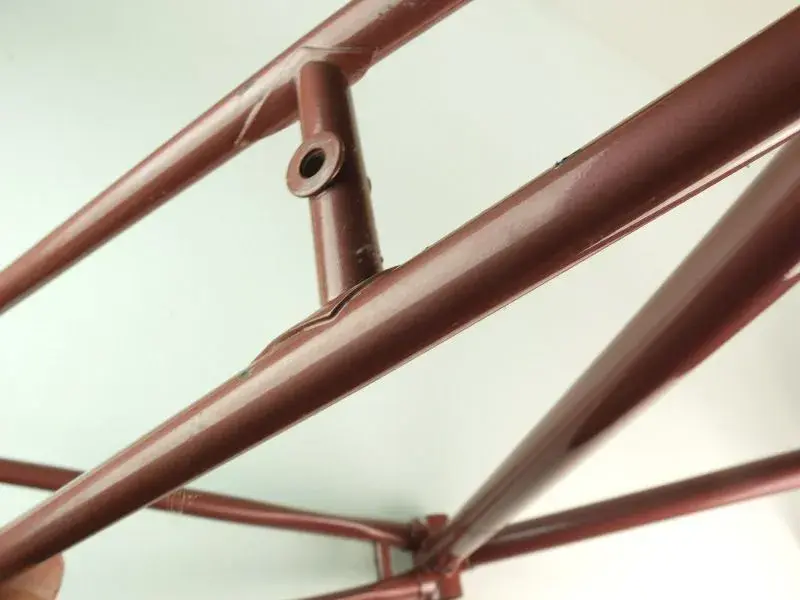

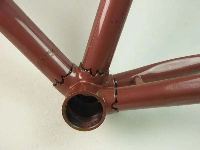

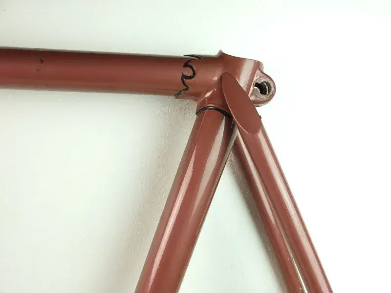

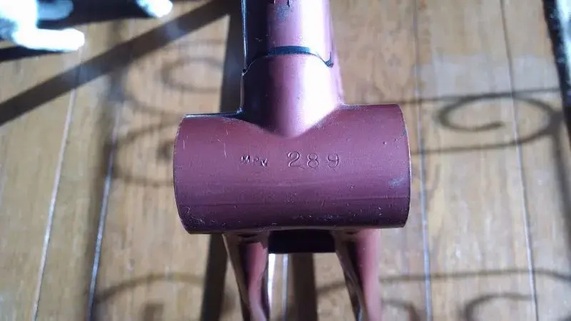

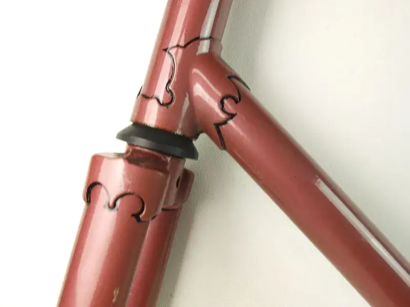

Hey Gents,
I'm nearly certain this is not a Holdsworth frame just from the number. I thought someone here might have some input as to what it might be.
What I know:
Dropouts: Campy
Serial Number MPV 289
The lugs are quite nicely done. The rear brake bridge may reveal some clues. The fellow I bought it from believed it came from the early 1960s because of the components that were on it. His guess was that it was a Mercian, Carlton or Holdsworth. I don't think it fits any of those frame builders numbering schemes though.
This frame is going to be the "working" frame for building up my Holdsworth Tricycle conversion kit. It's a bit large for me, but it'll do while I get the Holdsworth kit restored.
As always, thanks for your inputs and advice.

There is a period in both the 60's and 70's where Holdsworth moved to using a 4 digit system. There seems to be no leading zero so 3 digits would be right for numbers below 1000. The did mark them across the centre of the BB, but not seem one so far forward as this. For it to be a Holdsworth number your would have to ignore the letters which again is not unusual to have these as well but not as part of the number.
The lugs do look familiar, but I would start by trying to find a Holdsworth model that has all those features first. I would look around the early 60's, by 1965 they were back on the 5 digit numbers. I think identifying that straight rear brake bridge with the attachment lugs to a specific model would be the key. Then if that model was around in the early 60's, or possibly the 70's, then that would match the numbering system.
The history site is suspended currently, but there are catalogues available on the VCC website. Google would also have a load of images to look at. You can also look at examples of four digit numbers in the number data base. For the time being I am putting this in the other Holdsworth pile as a potencial. We do have others in this group with Nervex Pro Lugs which yours seems to also have.
https://drive.google.com/drive/u/0/fold ... TNKZkN4TmM
I can't recall those brake bridges being as early as 1960's. There is something about the frame that feels like a retro production, trying to look earlier than it is.
Are the ends Campagnolo?
Keith
