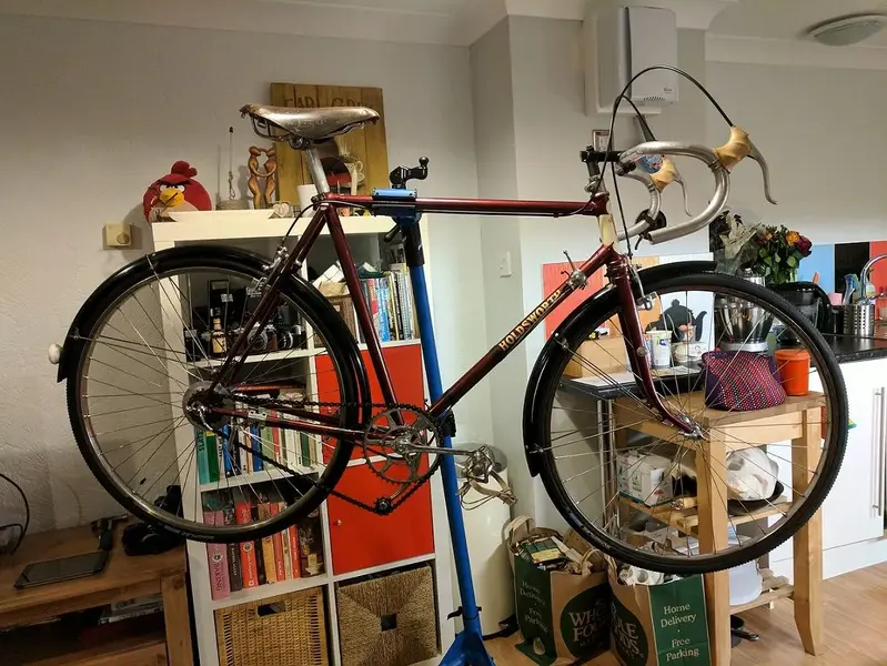

It is indeed a really beautiful frame. Very, very, happy with my purchase.
Fork blades are correct to the frame, Russ-style fork type, don't think they were reshaped.
I never heard about 7/8 or 3/4 differences and didn't think it would help age this frame. I shall look into it.
As for the wandering off topic, no problem at all! Always love to hear about these. Rest assured we all would love to hear more.
As for the Cyclo Ace I shall soon find out. It's on this one now

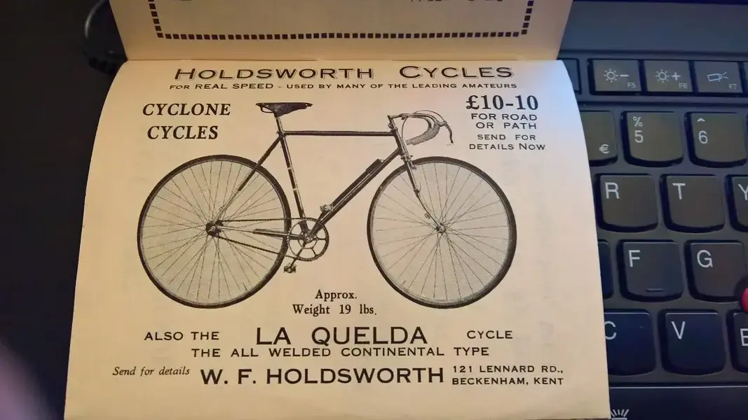

Btw just found out the Cyclone was available as road/path in 1937 too. But it didn't sport the Russ style forks, has a pump and front brake.
Probably the image is showing the road model.
Will add more info tomorrow.

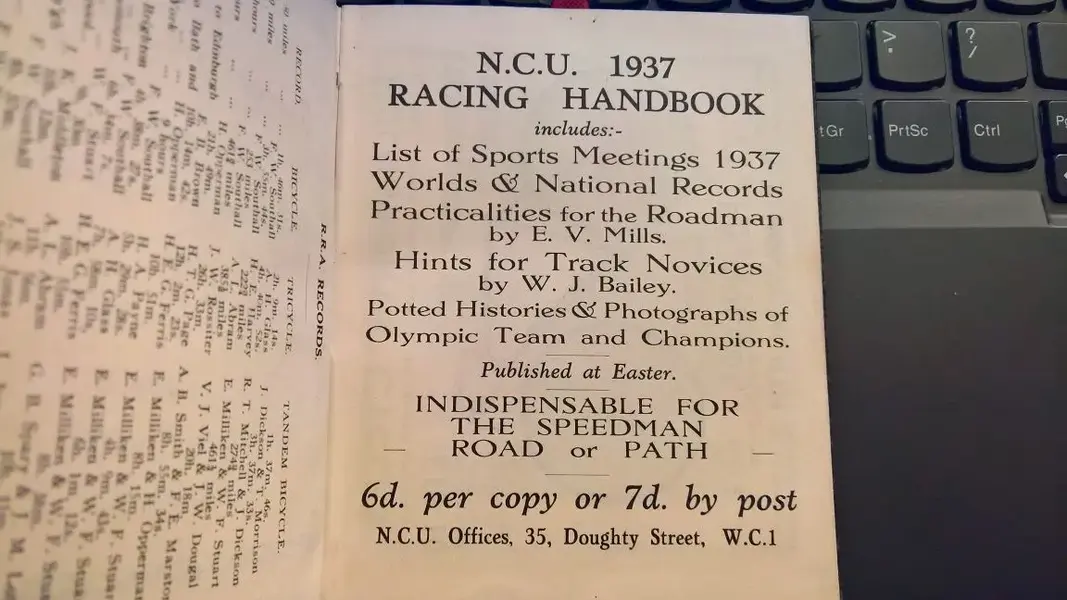

Here is the Cyclone offered as bike in 1937.
It's an in a nice little racing handbook.
