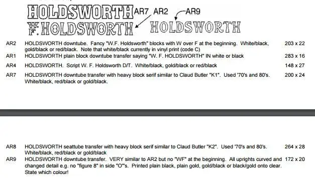

Yes, there is a whole host of options out there. The 70's seem very square with and without blocks top and bottom of the letter uprights, like AR7 below. But the third option above and the AR9 from H Lloyd are a bit of a halfway house between the 50's and 70's.
I have to say I was thinking of using the just Holdsworth one above, but more I looked I could not see where it fitted in. I guess unless it is 100% std rebuild it doesn't matter that much.

Either of the first two sets of transfers would be fine for your 58 Monsoon but the third set were later.
You can check out the 58 Holdsworth catalogue on Norman Kilgariff's Holdsworth website. See the link to it on the Classic Lightweights links page.

I think H Lloyd's AR9 or fancy script are both reasonable choices.
No doubt you have seen the Classic Lightweights article re classic frame builder WF Holdworth
( http://www.classiclightweights.co.uk/bu ... worth.html ) In it, Clive Holmes-Dowkes discusses down tube transfers. The fancy curved block letters with W over F, as in your first example, he says were present before the war and lasted until 1955. Re your second example above, the fancy script, the author says was only around for a short time between years '53 to '55.
The less fancy but curved block letters without W/F (H Lloyd's AR9) appears to have come along after '55 and were used into 60's . Thus, AR9 may be most accurate, though I don't have any good late 50's examples. The AR9 is what was on my '65 Typhoon originally and the same font was used on my '68 Claud.
However the Classic Lightweights article makes the point that there was overlap in years with use of down tube decals. Further, Kilgariff has an example on his site of a '57 or '58 Hurricane with the fancy script downtube decal.
So either choice is probably good. Personally I think the fancy script is classic and beautiful.
Maybe there will be other thoughts and good examples come along.
Another idea, at bottom of the C L article there is an example of a 1960 Monsoon with the model name in script lettering on the top tube. http://www.classiclightweights.co.uk/bu ... 05-220.JPG I know H Lloyds have this font/style of decal (AR11) for the Cyclone model and a couple of years ago while on the phone with the former owner Nick he used this script to make a same style decal for my '51 Sirocco and I might add - at a very reasonable price. Perhaps Steve would do the same.
Doug
Thanks that is helpful, I have already got the Monsoon top tube made up by H Lloyds, as always they were very helpful. Yes, I might go with the AR9 as I prefer this myself. it is difficult to tell what was fitted and did wonder if there was some overlapping.
