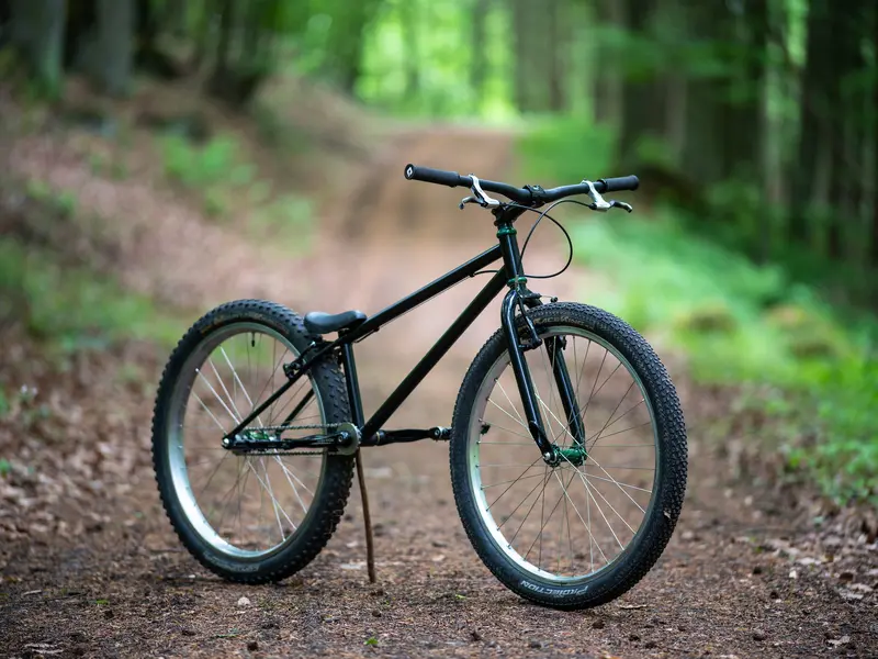

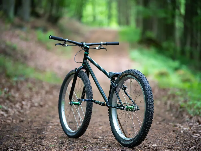

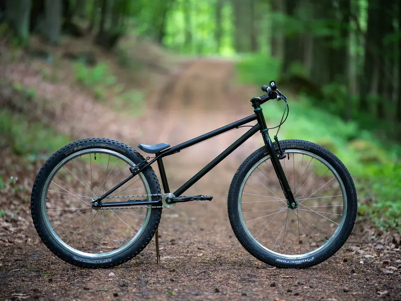

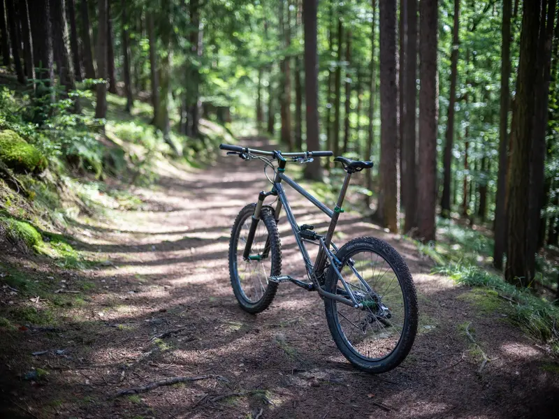

Lately, I've been missing trial riding. After the Uzzi became quite a versatile bike even for trips, nothing was stopping me from getting back into trial (after 12 years). Many components from the original trials bike were used on this fs bike as well.
I've always really liked the Leeson. My original trials bike was a 24", and I wanted it to look as nice as the 609. This time, I wanted a 26", so I aimed to get as close visually as possible to the 660 model. An original Leeson would’ve been great—except for a few technical details (like the BB)—but in the end, I once again chose Franta Mrázek. So now I have everything standard, enough clearance for the rear tire, and custom geometry.
Evolution I (completed after a week and a half, on March 16th.):
Frame: Franta Mrázek, 1020 wb, 375 cs, +20 bb and 73° ha
Fork: Inspired Steel fork, A-C shortened to 398 mm from the original 410 mm, pivots for 26" and without disc mount
Headset: Chris King NoThreadSet
Hubs: Chris King Classic
Rims: Mavic D521 Ceramic
Spokes: 2-1.8-2 DT Swiss and Sapim
Crank: Middleburn RS7 with titanium Super Pro Trial bash
BB: Race Face Signature DH
Pedals: Trialtech with Ti axles and modified for needle bearings
Stem: Thomson Elite 100x5
Handlebar: Black Sheep Bikes Flatter
Saddle: Cionlli
Brakes: Avid Single Digit 25 brake arms with SD7 levers
Tires: Conti Race King 2.2" Protection, Mountain King 2.4" Protection
Weight 9.9 kg

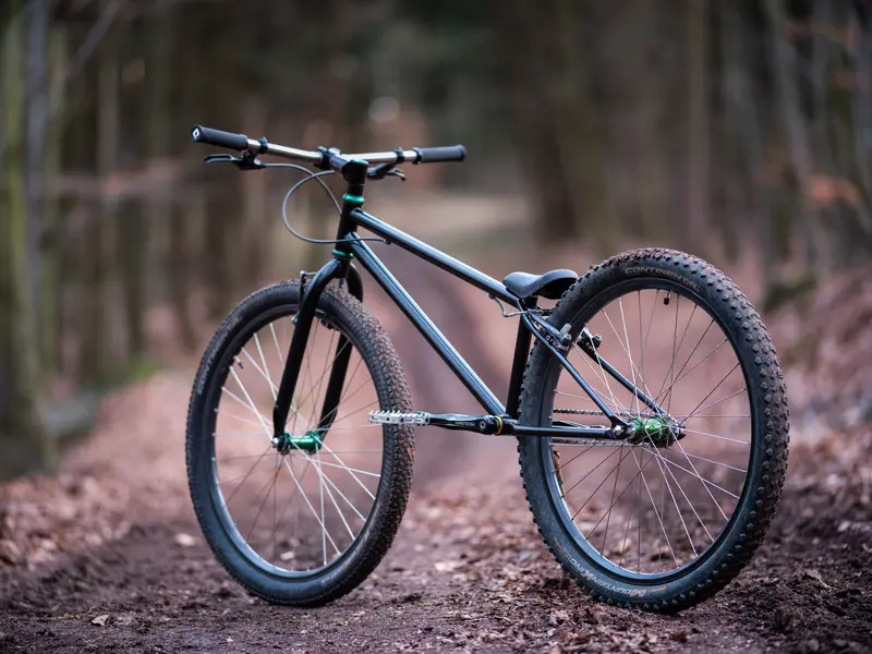

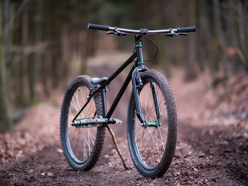

28th March: Mavic

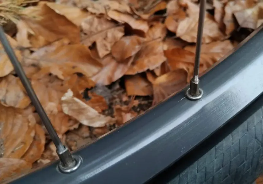

But just three weeks in, I found the rear rim was cracked in around eight spots. So changes came pretty quickly. I knew I wanted the Trialtech Carthy rims. I was still able to get the rear one, but unfortunately, the front with 32 holes is no longer available—production has been discontinued. So I had to look for an alternative and went with Dartmoor. Besides the rims, I also replaced the pedals, the handlebars and the stem. From today’s perspective, the Black Sheep Bikes Flatter bars feel a bit too underbuilt in terms of strength. I also swapped the brake arms for Deore ones, which have longer arms and therefore more leverage. I managed to keep the weight the same only thanks to a lighter (130 g) tube in the rear wheel compared to the standard one in the Evo I.
Evolution II (May 8th):
Rims: Trailtech Carthy Signature rear and Dartmoor Fortress front both de-anodized
Pedals: HT PA03A
Stem: Thomson Elite X4 100x10
Handlebar: Race Face Atlas ½“ 720mm
Saddle: Cionlli
Brakes: Shimano Deore brake arms with Avid FR5 levers
Weight 9.9 kg
I'm still working on the brake pads. I'd like to avoid sanding the rim, but that's a minor detail. I'm currently very happy with the bike and it brings me joy.
