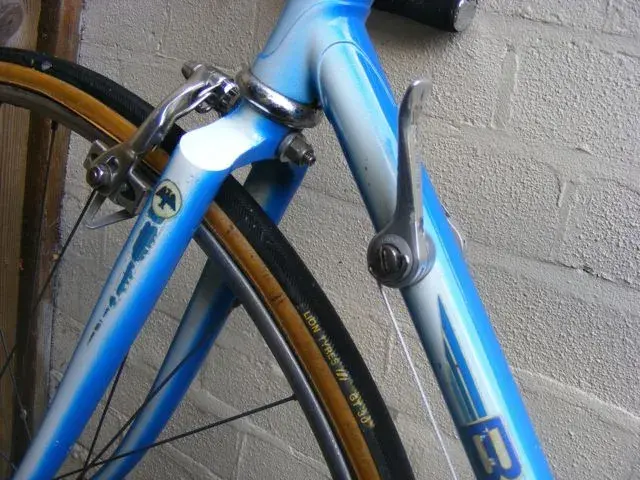

If you cant redo this in its original glory - seriously, just think about polishing it to within an inch of it's life and keeping the patina.
Totally agree: you can repaint 1000 times but it's only original once; don't worry too much about the odd nick or scratch, after all it's meant to be ridden unless you are starting a museum! thorough clean, keep bike cleaner away from the decals; you can T - Cut any small rusty bits then clear-coat the decals and little dinks, then wax it to within an inch of it's life!
I did that to by Bertin frame and you wouldn't believe how nice it is in the flesh...
