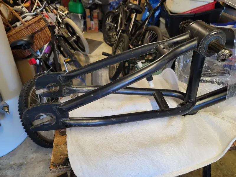

Hey just found this wrecked GT with odyssey parts, can I save it......? Looks early 2000!

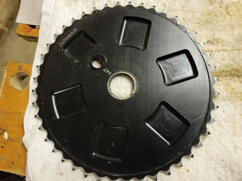

The chain ring is heavy, but solid only a few nicks and chips (Johnson 44T) , but overall cleaned up nice!

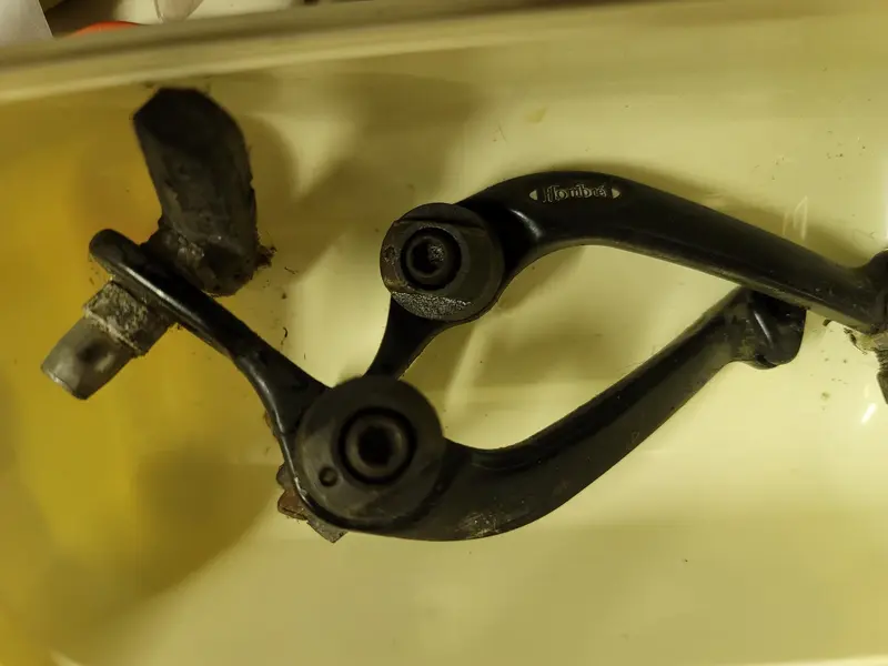

The Front brakes cleaned up nice, but have ordered some new mounting bolts and tiny lock nuts in black plus I'm still undecided about the original brake levers tech 77's. The Alu has been chewed up a tad, but I think I can either buy repo for £30.00 pair, or degrease and removal all paint, then sand down and finally respray, paint alone is about £26 for 2 cans!!
What to do.....? I could buy Shimano for less😂
At somepoint he/she must have lost a brake block at the front, as I found a rusty old BMX one, compared to the Yeystar ceramic shoes so I have three two rear only one at the front. 🥲
Can't seem to find them in the UK for reasonable money? Any help on this?

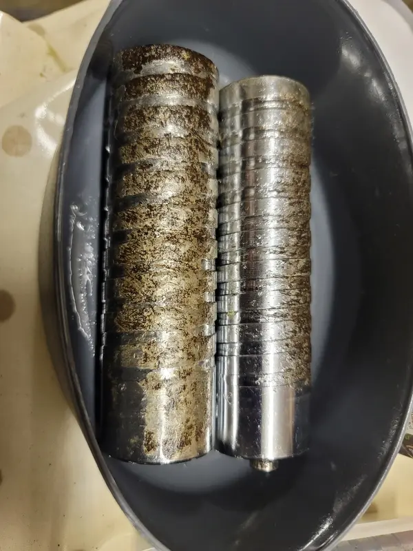

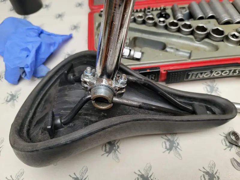

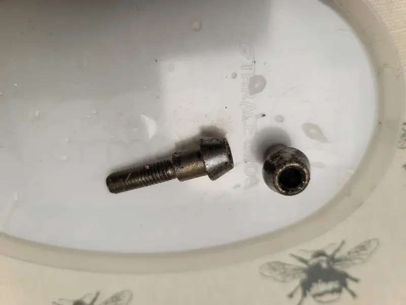

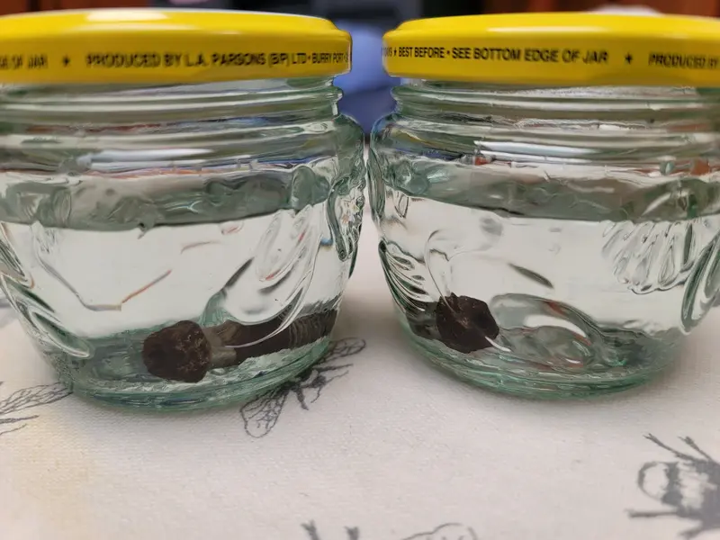

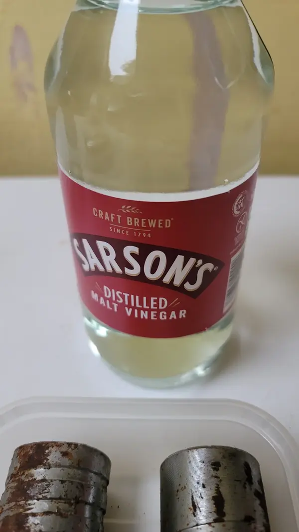

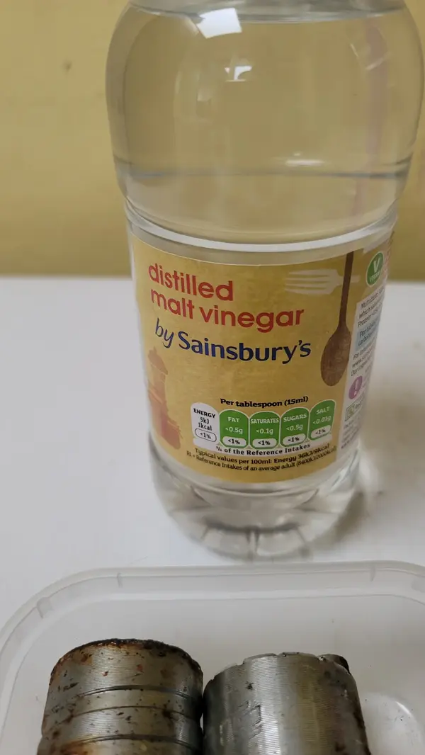

So little over 25hrs I did a small scale test of the cheap vs expensive vinegar.
I wanted to save this little seat clamp, double hex bolted and it was covered in rust.
The results the 35p Sinsburys came out on top (The longer bolt)
TBF I smelled them both and the cheaper one was like stripping my nose hairs, whilst the Sarsons made me wanted fish and chips!
Expensive one £1.60 was 5% acid and im guessing cheaper one was at least 7% which is why it made a better rust remover.
Each had 100ml measured and left over night 25hrs.
Also I used a wire brush to remove any debris.
acetic acid is what you want. it's made in vinegar and it's what gives it it's smell and taste. cheaper stuff tends to have a higher concentration of it because it's been distilled quicker and watered down.
Hey Novacaine!
It was just a test on the cheapest stuff I can buy 0.35P is not so bad for 570ml bottle plus Im at supermarket all the time.
I usually use wood bleach or Oxalic Acid, but its hard to get hold off and as you know prices have shot up.
Ive got some citric acid coming so Ill repeat the test with that stuff, but i've been given that stuff from a friend to try.
Acetic acid yes I can get some, but its also expensive like 2-3 pounds per litre plus delivery, might be stronger and quicker though?😀

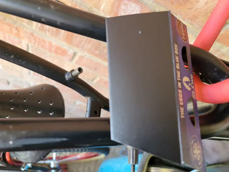

Definitley in a pickle about these trick nuts they have some serious razzor scarring, which I said the previous owner must have ridden her hard.
I'll go to seal them up best way I can, then turn them upto the good side, whilst crazy smashed side is facing down so I can't see it LOL!
I used 40g's of citric acid and 1litre of water.
This turned out really well, as you can see it took 35mins to strip majority of the smashed nuts.
They suggested 50g on the interney, but I thought 40g was plenty!
Anyways been testing my new black flat paint and its not bad match see for yourselves there is a undercoat for the flat black to fill those nicks and rust spots after I've cleaned them up.

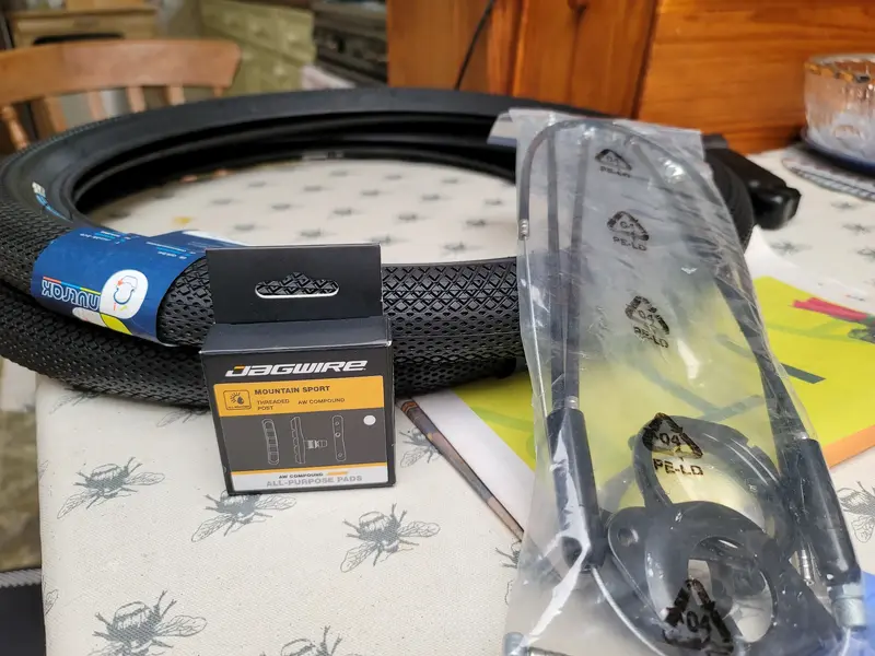

Ordered new gyro parts tyres and other goodies!

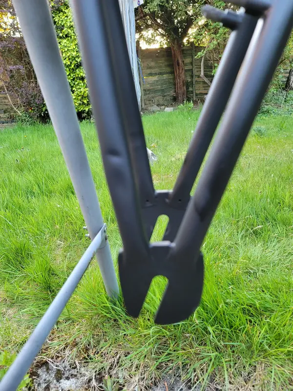

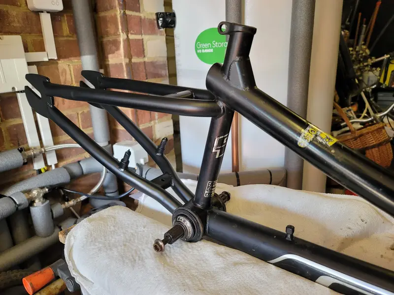

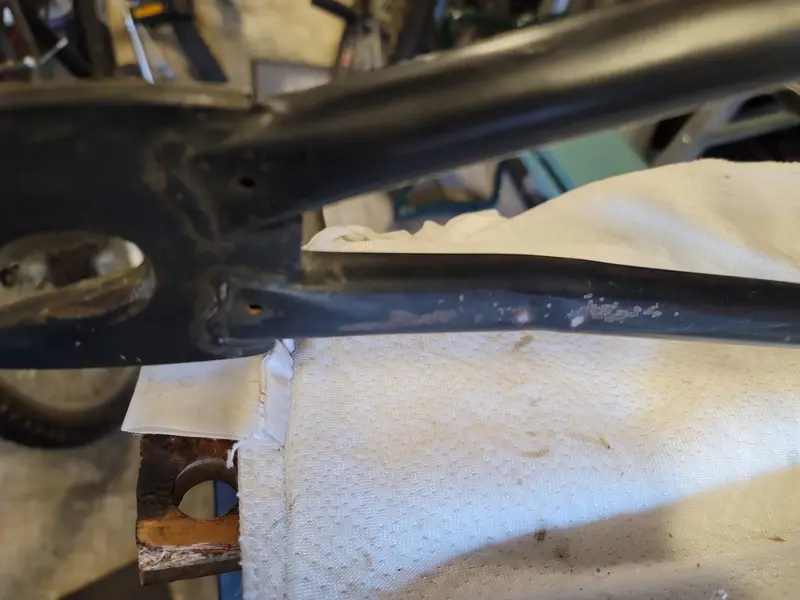

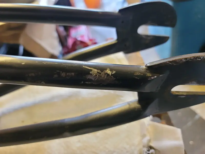

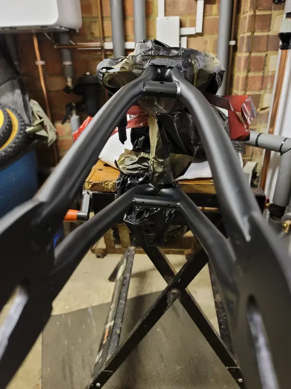

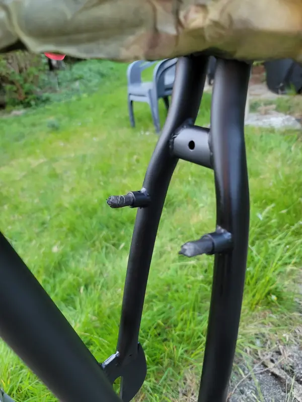

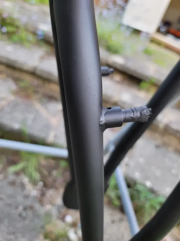

Another day........ Rubbed down the drop out end, to see how bad the worming and scars had taken hold and it was pretty average for a bike left to elements. I used very light wet and dry 1000 grit just to flatern any rough chips and paint.
Would have like to powerder coat everything, but hey I found this bike, and don't know where to even source the stickers for it? So repo ones I looked at was for other models in 2000.
A few coats of primer did wonders for any nicks and chips!:)
Colour match is never gonna be perfect, but close enough TBF.
I did the best I could as I don't spray, wheels is about the only thing I have spray 😇

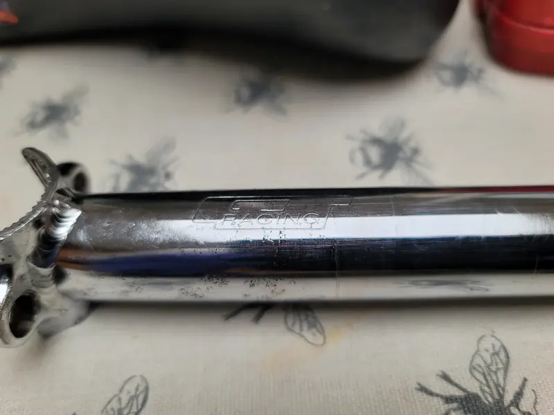

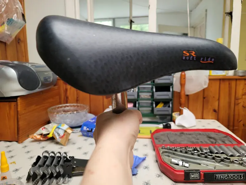

So stuff I could do, without damaging my hands. Found some old Snafu grips looks good to replace the worn out Primo ones.
I've got these bar ends with the bike really chewed out, just bearly name out Primo also. but these Snafu have built in ones so cheap yes works yes.

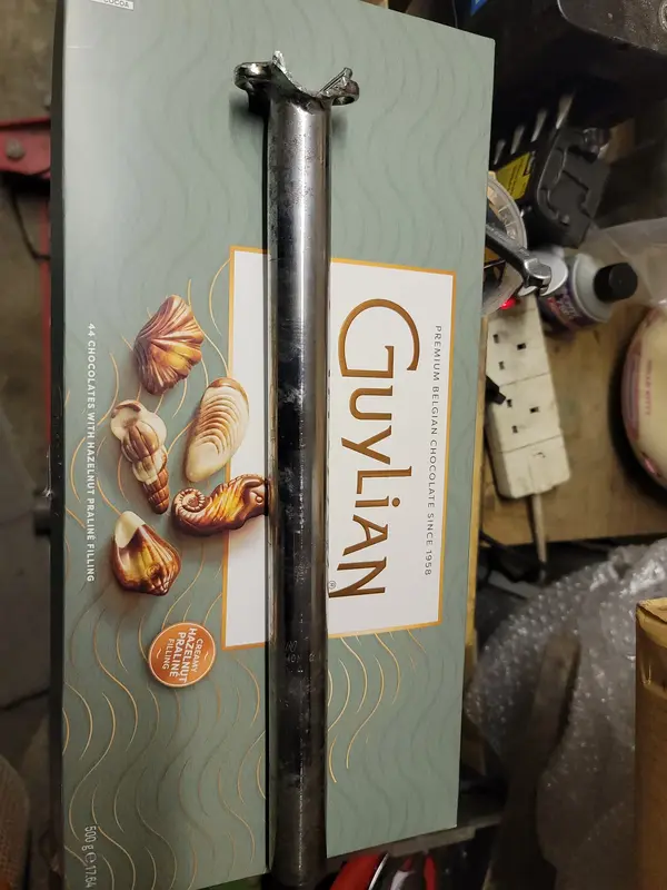

That GT seat I was not prepared to spend 30 to 150 on a similar worn out rough holed one so found this SR one and it looks OK. but the rail components have now been restored and light coating of metal protector seems to stop rust returning.I did the same for the trick nuts, but used a tough top coat to seal them. It was like rusting right in front of my eyes after I neutalised the acid 😳

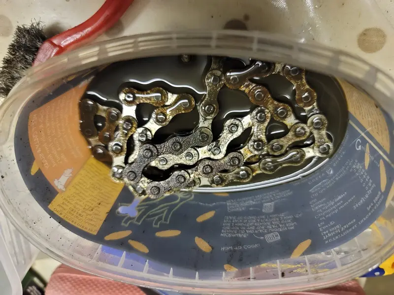

The chain was too nice to replace, it had KMC ST which apparently is super strength and won't stretch. Still cleaning it. But it's still flexing real good.

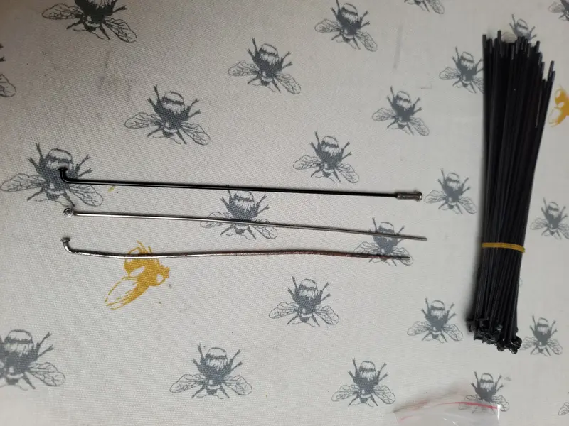

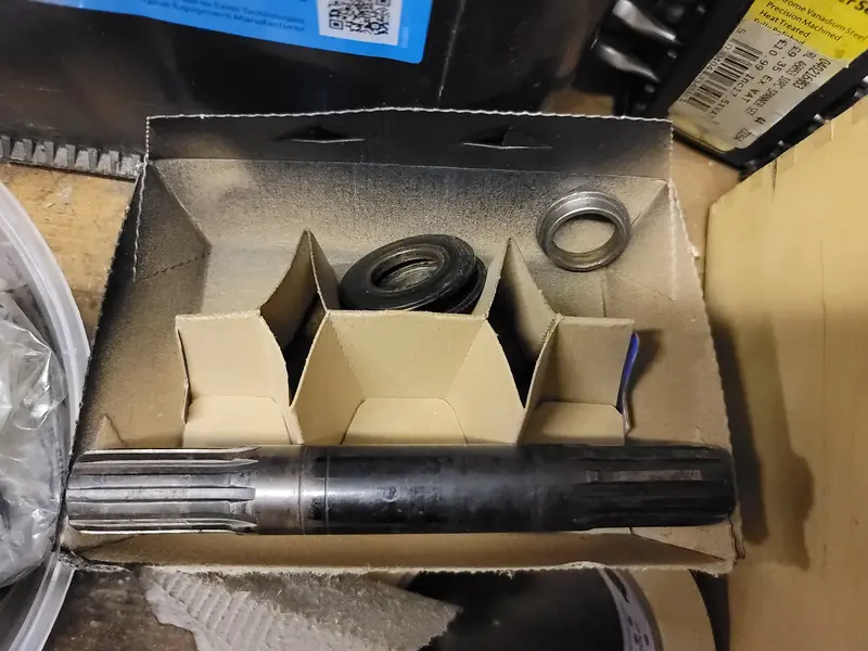

Removed the crank parts cleaned it up as with the spacers and bolts. Next is the front wheel need afew more days of resting as I've got to respoke and fixed the siezed hub.
