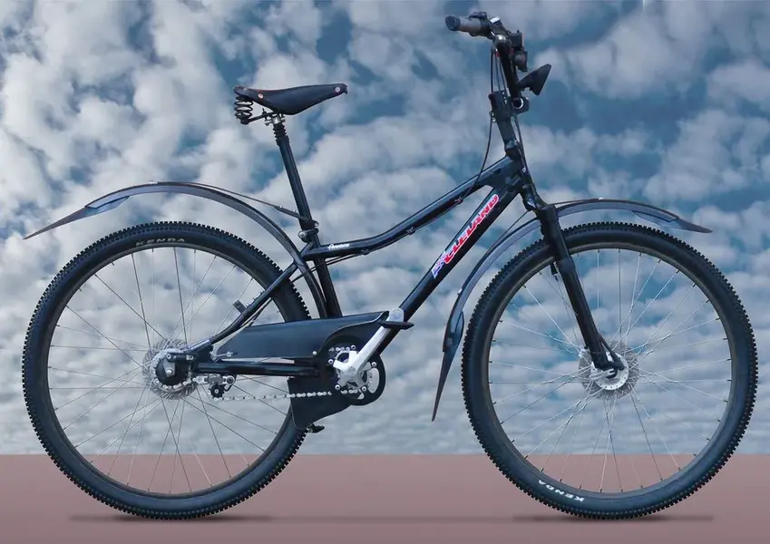

My initial reaction on seeing the bike was just how big it is. It makes any 26" wheeled bike look small and puny. However it's the wheels that are big and not the frame, it is very easy to get on and off and you don't need to be tall to ride it.
With most mountain bikes you climb on top in order to ride them. With this bike you sit behind the handlebars and you feel as if the bike surrounds your body as you ride. This feels very secure and because their is less weight on the front wheel the bike is easier to control, feels very safe and the chance of going over the handlebars is much reduced.
The Dutch bike appearance is to some extent superficial. In reality the frame angles are more upright than a Dutch bike, the wheelbase shorter and top tube is lower than a diamond framed Dutch equivalent.
One styling option would be to use a triple triangle frame like that of the Highpath' SpeedLight or "Big Blue" bikes. This would be more retro whilst achieving the low step over height required. It is also a very elegant and lightweight solution from a structural point of view.
What do people think?
The 1st two I can certianly see the attraction
the last one..the bits that stand out ..the chain guard and mudguards look like a diy piece of plastic bodge and so detract you away from the bike itself
perhaps it's those parts that make it look ..dare I say...home made rather than professional?..given that those bits could easily be rectified then I could see where they could go more positively

The Highlight style frame design is as applicable now as before, allowing steel construction, long head tube, high bars, big standover.
It's about a tool for a job, not a reissue or reenactment.
The key difference between the the Clelend & a modern design is the speed at which they intended to be ridden !? bolt-up-right & taking it easy, over spread-out & having a blast ..
The only thing about the Clelend design im not keen on, is the idea of being so up-right (re. saddle position, & lower spinal support) whilst riding the bumpy stuff. Your not in the best place to be able to shift your weight back (or off) the saddle to take hits so easily, (c.o.g not being properly distributed over the bike) & putting more stress on your back.
Not so much a big deal when your out in the countryside, taking in the view & wondering what the womans cooking for dinnner ! :D
