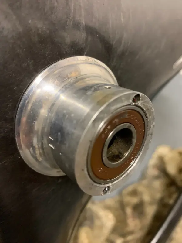

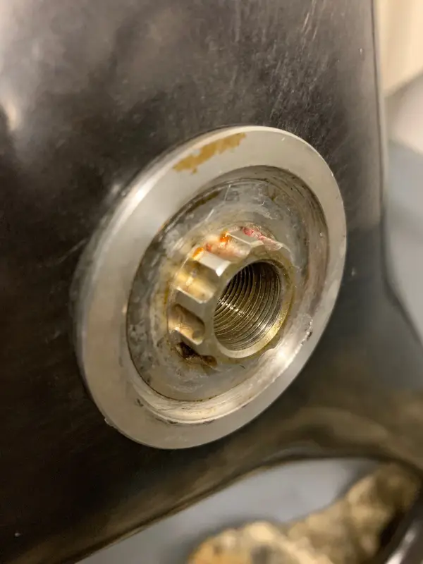

I have the two hole hub in my spin rear wheel, and id like to know how to remove the actual hub from the wheel if possible please?
I've heard that the hubs can be swapped out, so have a front hub i'd like to put in its place ideally.
I've got the Park SPA2 tool, to locate into the holes, but it all seems very tight (presuming its a standard counter-clockwise to undo)???
Am i missing something?
Any help would be great please - pix of drive side and non drive side now attached
Thanks in advance...

Hi, if memory serves me (it’s never need great mind) you have the original wheels which have the hubs glued in and so can’t be removed I’m afraid. Unfortunately they where also prone to coming unstuck. I know this because I had to warranty my original set. It’s also why they redesigned the hub.
