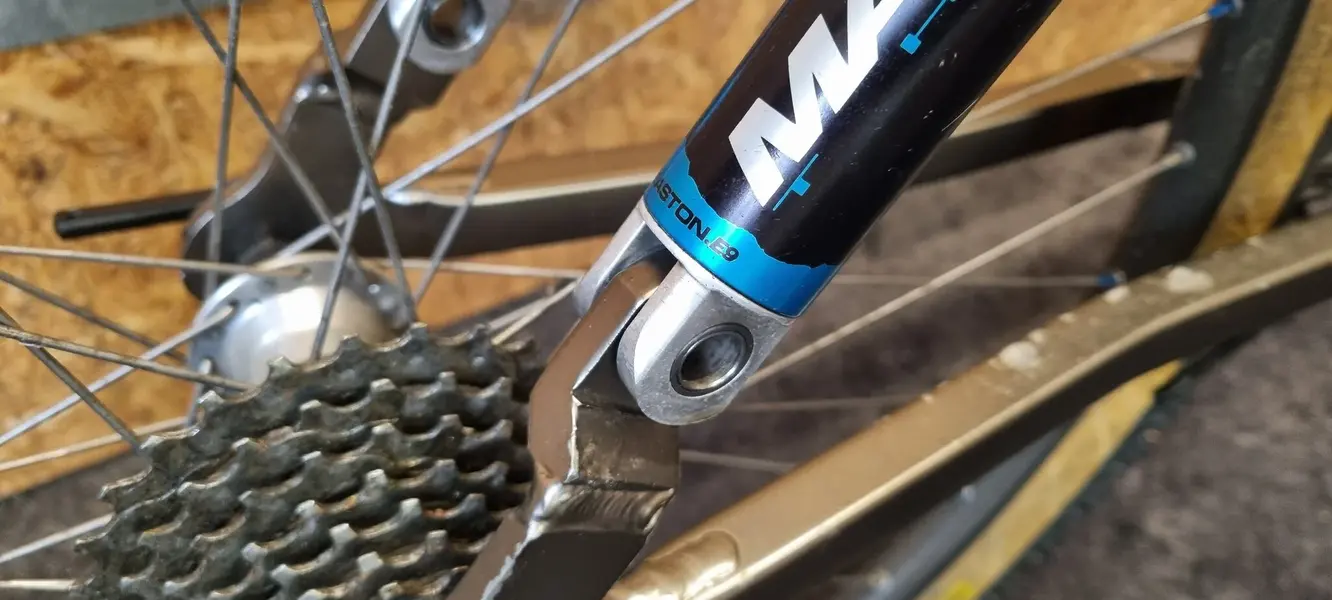

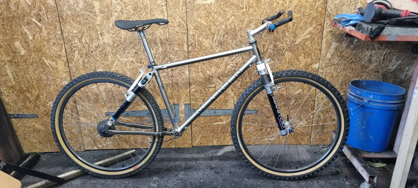

Has anyone got any links to a how to remove the rear bushing on a Marin Pine FRS
It needs paint, I was going to leave it but the perfectionist in me can't cope 🤣🤣🤣🤣
Thanks Dave 20240428_154343.webp 20240428_154340.webp 20240428_154337.webp 20240428_154827.webp
I've not had one of these, but on various Amp research bikes I think there's a grub screw holding the axle in place. Undo and it should push out. Or it could simply be a case of the stay sections holding it on?
Simply push fit/interference fit.
The pivots are steel tube on nylon Bushings.
I made a press/drift tool using threaded rod and a selection of sockets and washers, worked a treat.
