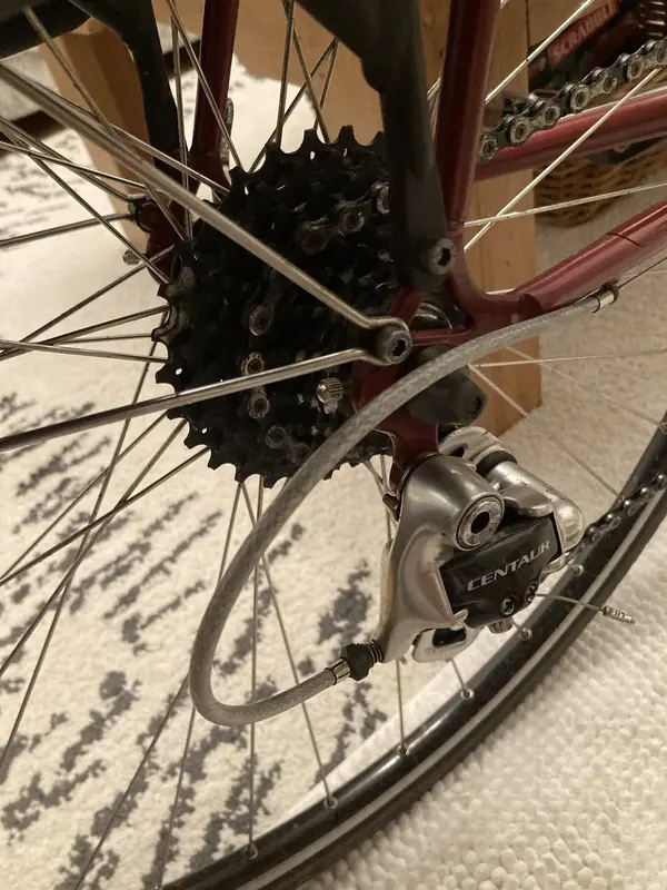

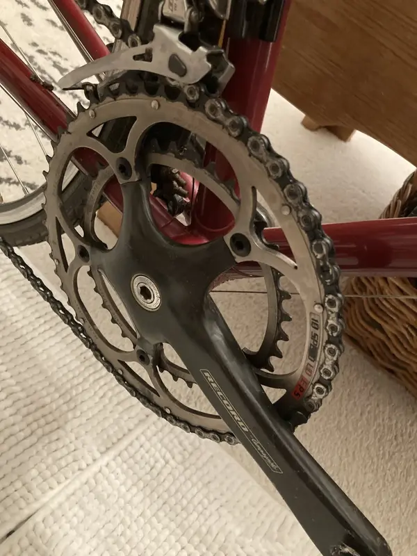

I can confirm that it works fine. I use 29T cassettes on both my Centaur 10 speed bikes with a short cage derailleur and 53/39 chainset. I’ve used this set up with Ergos and DT shifters without issue. I use Ultegra 10 speed chains and Miche cassettes.
53/39 Record, 29/13 cassette, long-cage Centaur mech, Centaur f/m, Centaur 10spd brifters, KMC 10spd chain all plays nicely. The chainset is swapped out while I had the bearings replaced on a Centaur carbon U/T and that worked fine (also 53/39) if that helps :)
Edit: this is a centaur cassette but have used Miche as @Ducky suggests with no issues either.
