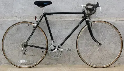

Customer sent me the attached pic, not been able to confirm that it is actually a Thunder though?
I've never heard of it either and no real confirmation on the web yet.

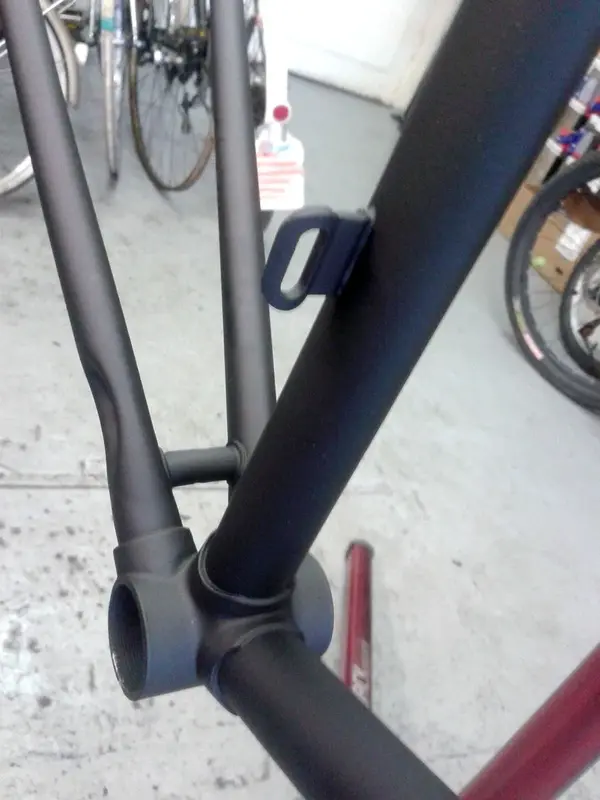

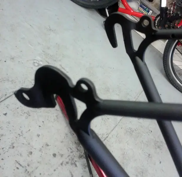

And here's a couple of very bad (sorry) photos of the frame as I've got it now.
Oval seat tube and braze on mech hanger.

Purely guessing, but I suspect this is not 26 tpi. Check the bottom bracket threads. It looks far eastern to me.
You could fit a 24 tpi head set.

It's much newer than 1973!
I'd say it was a 1983 Raleigh Pulsar (18-23 Tubing), a Team Cadet (18-23 or Reynolds 501 Tubing), Quasar (Reynolds 501 tubing) or a Record Sprint (Reynolds 501 tubing)
These bikes came with 'Aerospace Contour' tubing (round, oval, round down tube and seat tube)
Forks are fairly generic, they would have left the factory with 18-23 High Tensile tubing with Tange Sloping Crown
Wheels would have been 700c in all cases
http://www.bulgier.net/pics/bike/Catalo ... l84_06.jpg
http://www.bulgier.net/pics/bike/Catalo ... l84_07.jpg
http://www.bulgier.net/pics/bike/Catalo ... l84_08.jpg
http://www.bulgier.net/pics/bike/Catalo ... l84_09.jpg
That's kind of what I thought, that it would be a 700. I sized up a spare 700 wheel in the frame and it looked at little small for the frame, 27" fitted the frame better.

I'm 100% sure it is what I said it was (I have a frame hanging in my garage, it was my first ever road bike many many moons ago!)
