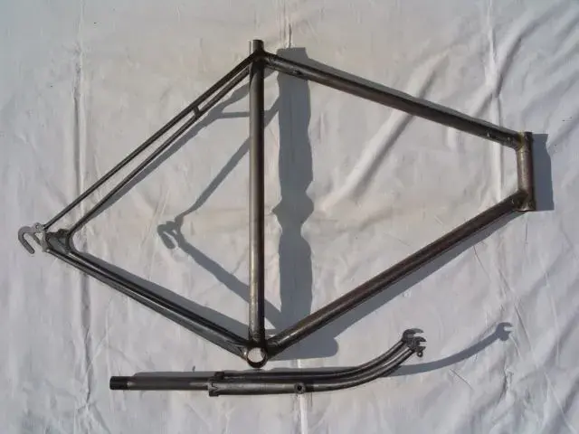

Hi,
Just got a 1954 claud butler new allrounder frame and forks and I'm trying to work out the best parts for a period rebuild.
I wasn't sure wether to go for a 4 speed or 5 speed as finding 1950s derailleurs for the 5 speed is near impossible.
Could anyone help with a list of period parts it should have????? and to go for a 4 or 5 speed. I'm planing on going for a double chainset as I want it to be practical to ride for hills.
for the brakes i thought maybe GB Coureur Hiduminium.
As for the derailleurs and free wheel and chainsets I don't know as i want it to be close as original as I can get. I planned really to keep most of it CYCLO benelux.

Hi, the distance between the dropouts could help you decide, I suspect it should 115mm for that period. If it is 110mm it was either a fixed wheel or sturmey hub. Terry

Claud Butler did a similar fit to a lot of their models through the 50s. I think you'd be looking at Benelux 3/4 speed, or Simplex. Williams chainset, Baylis and Wiley bottom bracket, TDC headset, Phillips pedals. As you said GB brakes and levers, Maes type handlebars and most likely a Brooks B17. I have the same set for a CB Jubilee rebuild.
Wheels can be the biggest and most expensive problem depending on how period correct you want the bike. You'll want 27 x 1 1/4" and there are good new alloy options. Period would be Dunlop stainless rims which are out there but getting more difficult to find.

Just measured it and its 11.5, does that mean it fit both a 4 or a five speed?
Cheers robbied for that list its a great help and looks about the same as what I was looking at :)
Found a lovely Benelux mk 7 4 speed derailleur on eBay. Think its from around 1957, thats about the earliest 4 speed I can find so think I might look into that if it doesn't get to pricey.
