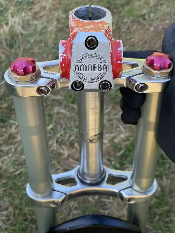

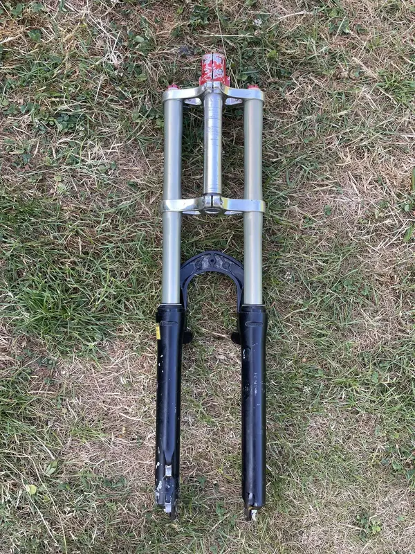

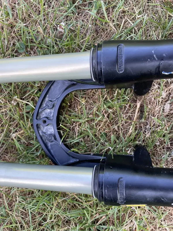

Got it dirt cheap and I like the look. Seller didn’t know anything about it. Anyone know what year etc? E83F5E92-BB38-4545-B8D6-BD5F97B3A805.webp 7B540F2A-948B-452E-A5B4-1D86D8A05D05.webp 21D83C2E-2F5E-40F4-8414-2CB2EB1BAD7A.webp 56915900-8BE6-4CD1-A382-914C801C4AAE.webp

your pictures showed already everything, also the date of production (both stamps at the inside of the arch)
SR Suntour MG DH Fork, produced End of 98 for 1999 saison.

2000g is still lightweight for such a fork, looks like the magnesium casting is contributing to this.
