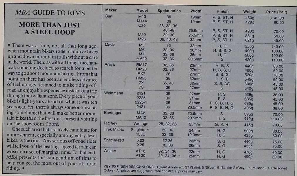

There was also the even wider Mavic M281 (and predecessor Rando M5), but with all these wider rims (M261, RM25) you´ll struggle to find them NOS as they were quickly getting out of fashion at the start of the 90s. Making that task nearly impossible is to find them in 32h variety. These rims were made to be extra strong and were mostly specced as 36h.
Here´s a rim overview from 1989:
M281 are also a lot lot heavier built than M261. I mean a LOT!
I built a set last year and compared with my normal m261, they are serious bits of kit.
If you can find a pair do....

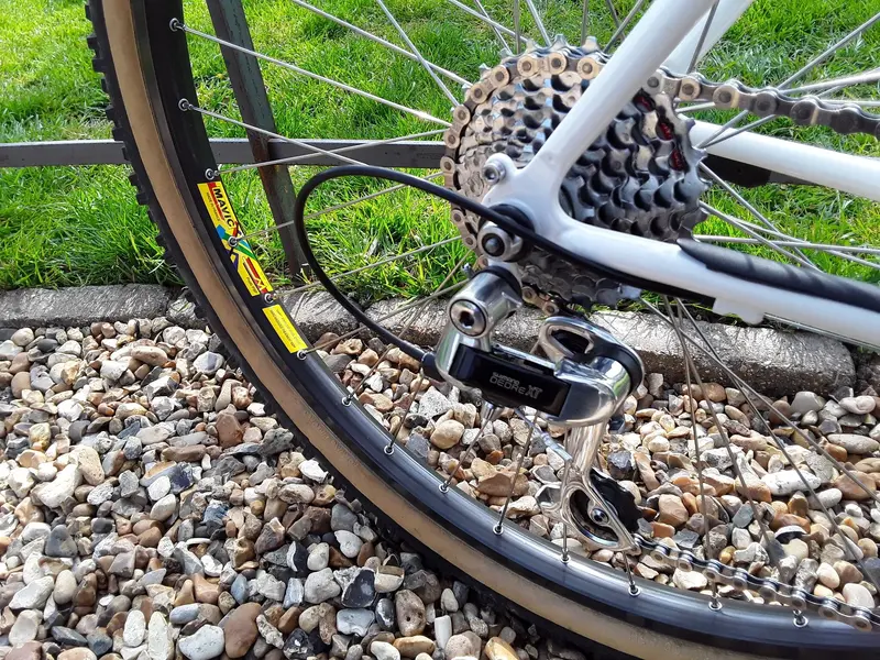

Mavic M6CD or M7CD would be my go to on an 89. M7 slightly heavier but bomb proof.
Yeah would love a pair of 32h Mavic M6 but man are they hard to find!
I found some really nice MA40s that are mint but they're $$$...so for the meantime in order to get this bike on the road the non '89 specific 230s will have to do.
