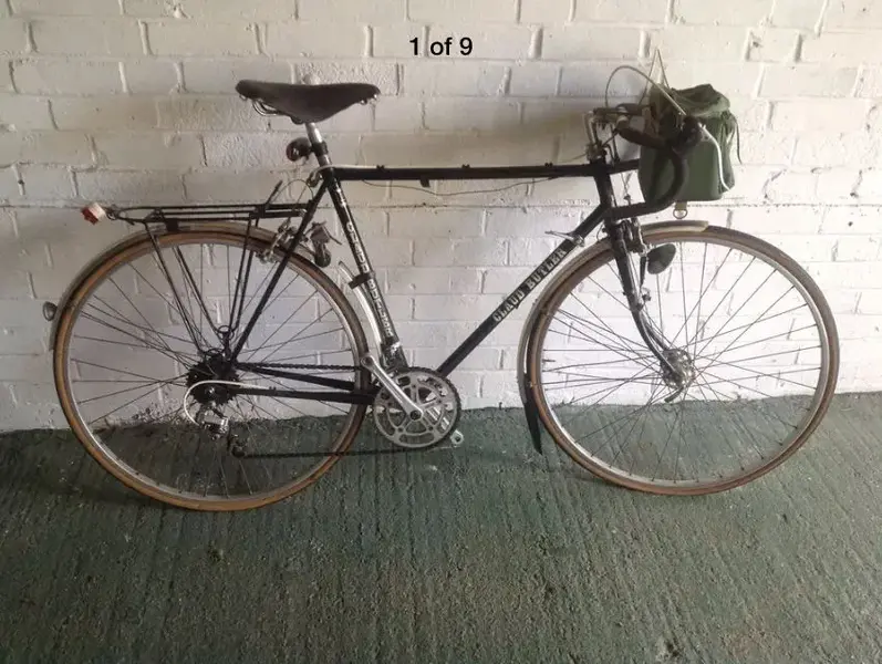

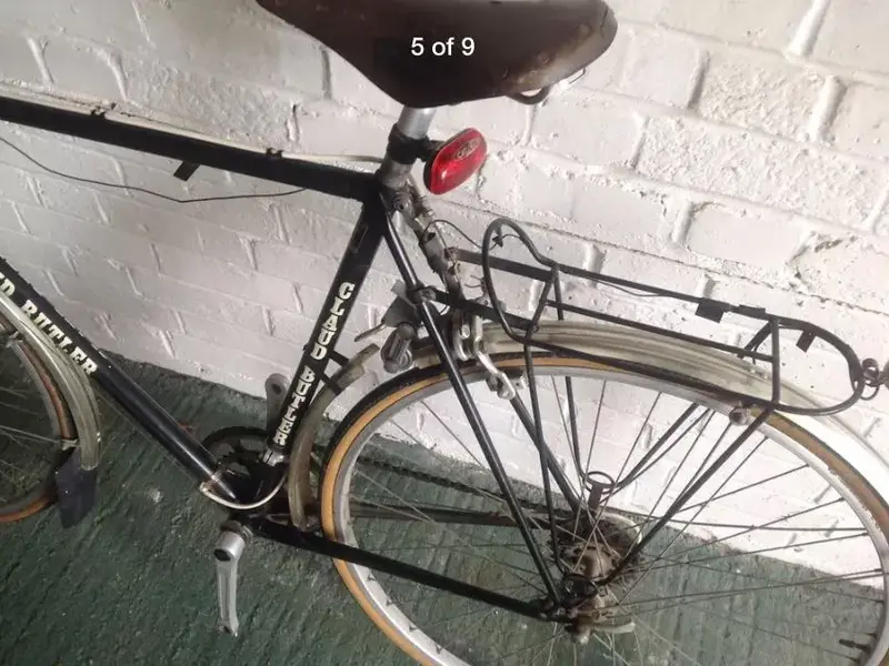

There’s no way that it could be a 1983 Majestic model as that has no cage mounts on the frame? It also has matching 531 frame tubes and forks, similar cranks, matching mudguards and rear rack. The only thing that is different on mine from looking at pics of the 1984 model are the horizontal suntour dropouts and the black paint job, but these could have been different on the 1983 model? Cheers

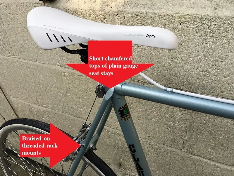

Nope, the rear rack braze-ons on the seat stays apeared for the first time on the Majestic in 1982.
To explain, here is my 1984 Majestic, with braised-on threaded rack mounts and short chamfered tops to the plain gauge (not Reynolds) seat stays.

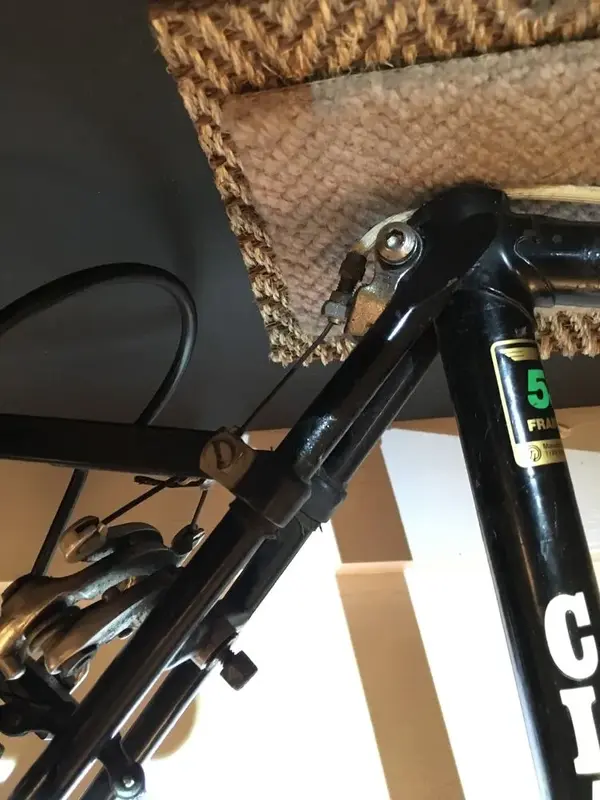

It's hard to tell in your photos but the tops of your stays look more elongated?

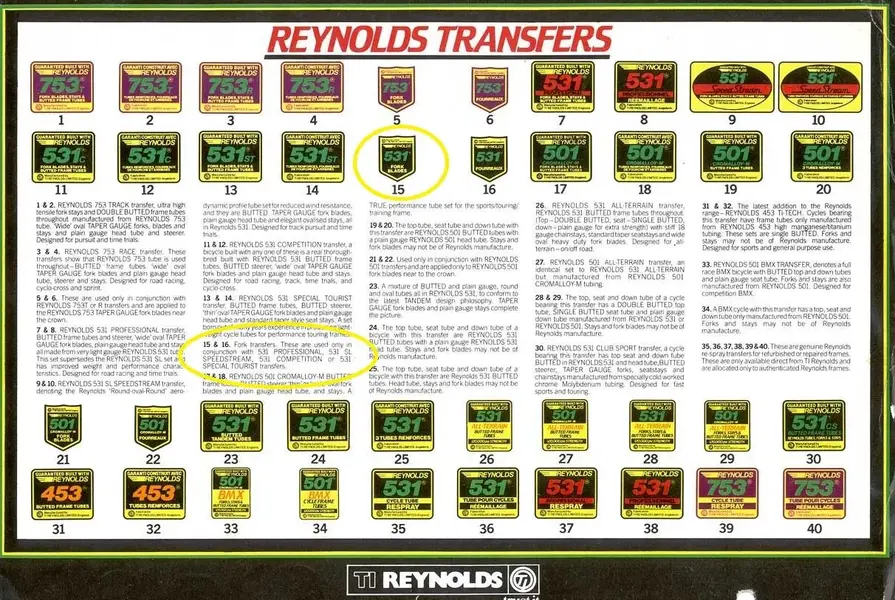

Your Reynolds fork decals are later versions than those on '82 catalogue pics and is perhaps more evidence for an '82 repaint. Although... end of '82 was right at time when the change in decals took place. Here's HLloyd's Reynolds timeline:
https://cdn.shopify.com/s/files/1/1301/ ... 9566035148

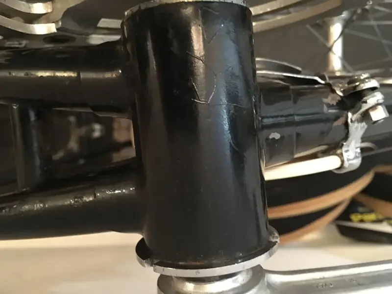

In year '82 catalogue the Cresta and Majestic appear to be only models without brazed on BB cable guides. So this narrows the field as yours appears to have a clip on DT at BB.
The kit on your bike (although not definable) appears to favour the 1982 catalogue Majestic over the Cresta. (LF as opposed to SF hubs, chromoplastic as opposed to Bluemel mudguards and a 36T as opposed to 40T small chain ring.) Also your bike has same model rack as pictured in catalogue whereas Cresta has none and when comparing 82 and 84 catalogues I am convinced the '82 rack is not attached to stay braze-ons.

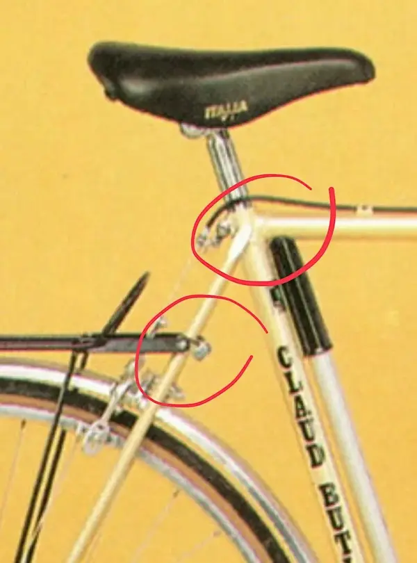

Catalogue pic of a 1982 Majestic seems to have a longer chamfered stay cap (as yours appears in decal photo) than PeachyPM's 84's shorter cap. Suggests a change in design in '83 or '84?

I had to go back & check.... He’s only bloody right!
Well done Doug, you are quite correct, the ‘82 Catalogue does show the Majestic with longer seat stay chamfers and it’s doesnt have braised on rack mounts....
I’ll get my coat..... :facepalm:

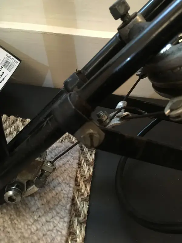

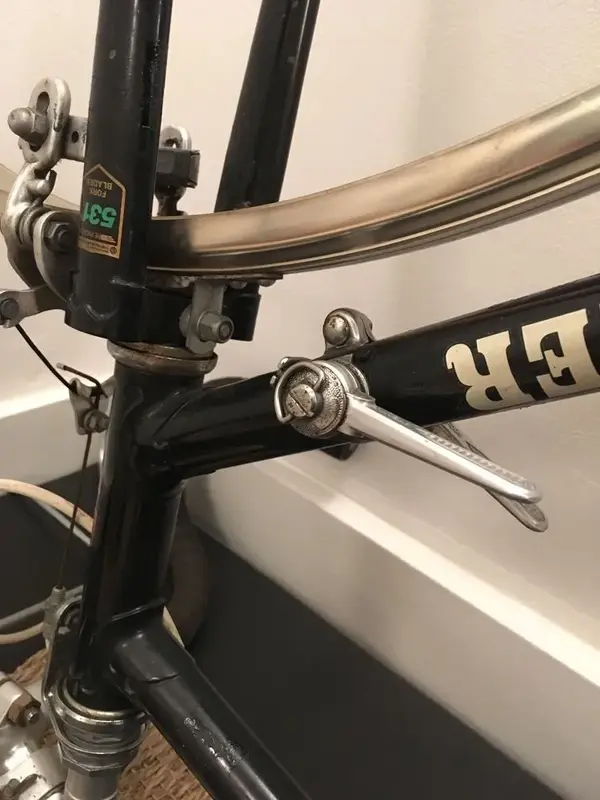

Thanks for all of your feedback I appreciate it. I've uploaded a few close up pictures showing frame and paint details.
I've managed to speak with the seller on eBay who I purchased and collected the bike from last year. He couldn't shed much light on the bike as it was his brothers but finds it doubtful that the frame was ever re-painted as his brother owned the bike from new and it wasn't used much.

Well.. not entirely 101% clear without a 1983 catalogue, but I'm leaning toward a 1983 Majestic.

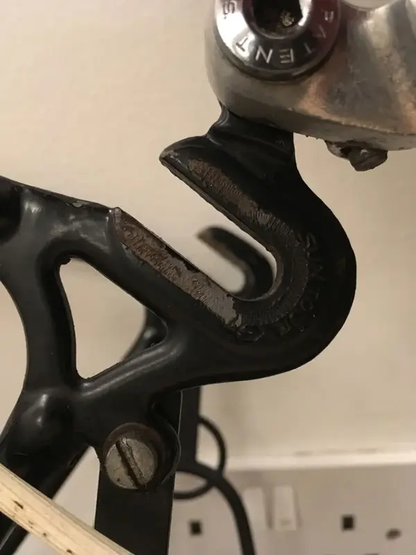

The Suntour "semi" forged dropouts (as present on your frame) are specified as standard on Majestic for 1984 but are not described as such for 1982. Coincidentally, the '83 Holdsworth models catalogue is actually present on Kilgariff site and does list for the first time the Suntour dropout on the '83 Avanti model. (Hard to see dropout detail on '81 Flickr example as closeup is fuzzy.) HLloyds' Reynolds timeline describes your style decals as coming in to use post 1982 and are different than decals shown on 82 catalogue, yet are present in 1984 catalogue - again pointing to a 1983 model. History from seller is strongly suggestive of never being repainted, so black very well could have been colour for 1983. Having said that I have seen examples of buyers requesting a custom color and being obliged by factory - so perhaps was a special request. Certainly they advertised doing such for higher end models as Mistral on up.
Your serial plotting to late 1982 on Dave Scrimshaw's prediction would not be unusual for a 1983 model as next years models often began production in the fall of the year. His prediction table has had several revisions, the last being done after the number of serials had reached 600ish last year and after a lot of discussion and thought. There may be another revision in future but I think it is presently pretty darn good. Dave does not claim 100% accuracy and emphasizes prediction should be used as a guide with frame details taken in to account. Anyway, for your bike to have been actually built in 1983, prediction would only need to be off by a couple months.
So... I think your 1983 Majestic is likely all original kit (except seat) and it should be safe to leave it black. Maybe it looks worse in person but in pics paint and decals actually look good to me. Luckily, black is probably easiest colour to touch up, if one decided to go that route. Some would say it simply needs replacement of consumables, cleaning up and waxing. I'd say whatever floats your boat! Nice bike.
Totally concur with Doug, Black should be an easy touch up, if original it’s rare enough to warrant keeping the paint and that odd combo of tube transfers. (I had my ice blue Maj re-sprayed but they are a dime a dozen)
