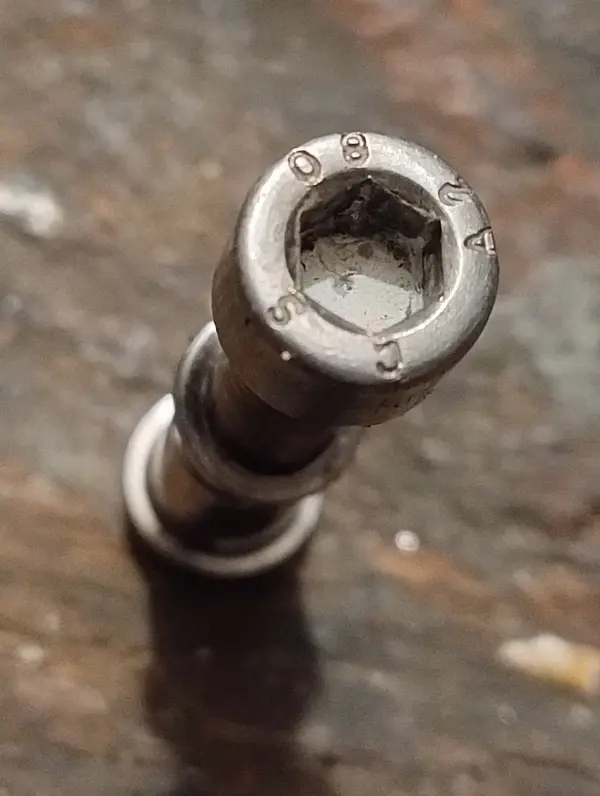

So, ladies and gentlemen. When I was thinking about fitting of Tektro cable hanger for a fork, I suddenly realized, that brake pivot nut can actually do the job as a left part of the clamp. Quickly measured everything, found a pivot nut from a broken Sram Force road brake (even holistically correct), cut normal bolt to approx 27mm of a total length - et voila, it seems to work :D The pictures of the end result are attached. Haven't yet tested it, but seems to hold just fine.
Overview:
Left side:
Right side:
I'll post the overall picture after few days of testing.
