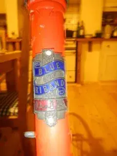

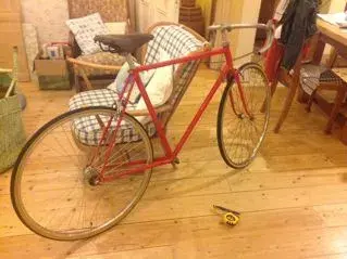

PIcture of the bike as it is at the moment. Not a great paint job (!) but will think about that once I've got it going.
Bigger/better picture would be nice.
Rk.

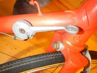

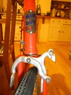

Thanks for all the help. Just got to chase down the parts now. Here's a few more photos, hopefully a bit better.
