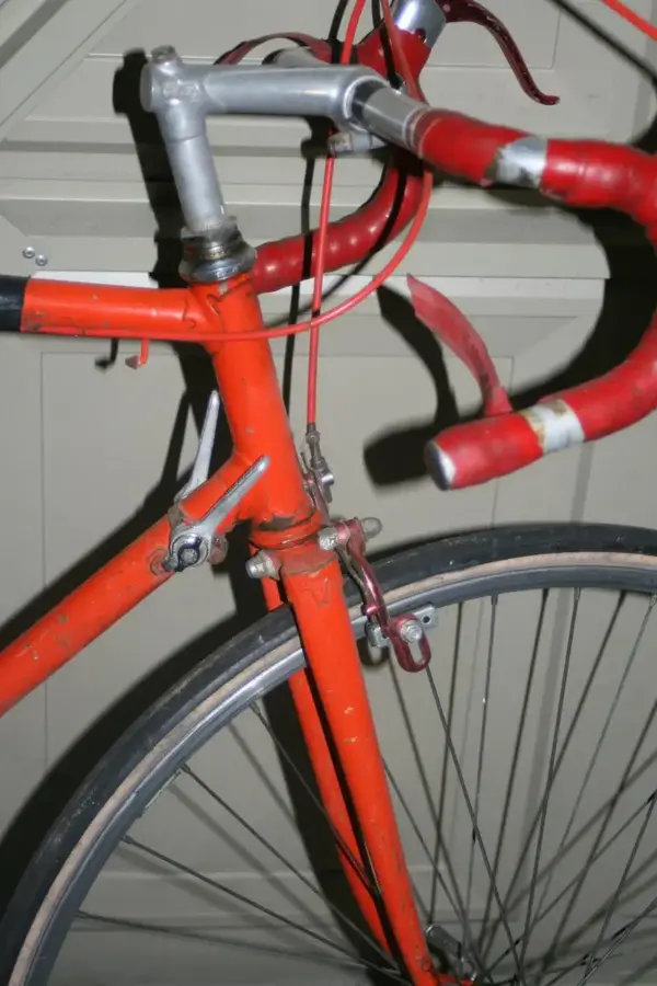

But then I saw a 'vintage rusty racing bike' and remembered my Dad having a bike with similar styling .. where the tubes weld together? the tech term escapes my mind at the mo.
I did a bit of research and i think its a Holdsworth.. Dont think its Claud Butler.. Please see the pic below.
Things ive found.
Rubbing the frame down it appears to go back in the following colour order as you strip it to metal.. orange respray, grey undercoat.. red.. cream.. orange and then it stops at bare metal I think its probably had a long and multicoloured past!
On the headstock, where the name badging sits, there are no screw or rivet holes, so i assume it was decalled or bare when it was built.
The BB is rusted like my card playing (and im proper rusty at that) so i cant make out any stamping.
As your sat on the bike there's a 'pimple' on the left top of the BB which I assume is (under the rust) a grease nipple.
Its got various brazed addditions.. rings where the cables pass, etc
Errm.. thats it I think. Im sure the attached pics paint a thousand words.

Spokesman might chip in but it looks a bit Carlton ish with the wrap around seat stays......
Shaun
Looks very Carlton-ish, like you say although the ornate headstock design (what IS the word for that?) ive not been able to match against any of the Carltons.. also the forks ive noted for the most on the Carltons have a 'bolt hole' on the right fork for a lamp bracket..

If you can see the size of your seat post, stamped top rear, you can judge the tubing gauge, 27.2mm would indicate probable butted 531. The seat tube is 1 1/8 inch outside, so you can calculate the thickness of the tube.
It looks more like a Viking, did they have a head badge? from perhaps the 1960's.
Any chance of a close up of the seat lug / wrapover?
Well, it's a handsome devil, at any rate.
I think those lugs are Prugnat - I've got a couple of Claud Butler frames - one from 1963, the other from 69, so both from the period when CB and Holdswoth frames were often the same with different paint jobs - which have the same design lugs. The 1963 frame has a grease nipple on the bb shell too. So you might be right i.d.-ing it as a Holdsworth... Then again, I think Holdsworth were pretty wild on sticking metal head badges on all their marques by the 1960's.

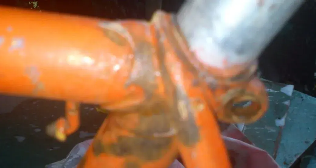

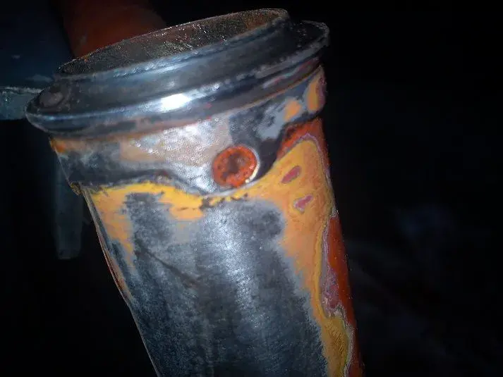

Well curiouser and curiouser turns the tale..
Courtesy of Nitromors, I can now reveal that the rear frame dropouts are Brev Campagnolo's and on the left hand one ive found a serial, 59274 The 9 amd 2 are debatable but with a microscope im sure theyd show as that number the top bits are JUST readable. My search continues but maybe that info helps?
Few pics from as im stripping back the paint. note earlier orange coming thru from the lower layers in the serial number pic..
top front of headstock shows the design. note the apparent 'hole' isnt.. its a crescent shape? Hope that makes sense.. pic doesnt really bring it out well. bottom design matches.
