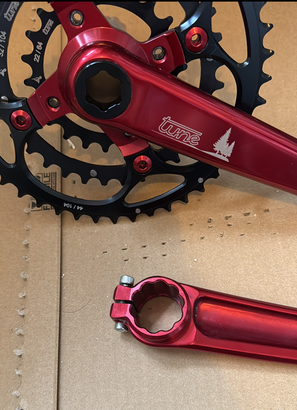

Thanks mate, the problem with tapping it from the back is there isn’t much room to get in there and tap (because the cranks are fitted to the frame)We've got 2 and 3 legged pullers -
you need something to sit on the axle end to push against, and something to prevent marks on the back of the arm.
Also a bearing splitter will do the job, but can make a real mess, so only if you want to replace the crank on a beater, like it's got a damaged extractor thread on a taper fit.
I'd assumed that tapping the back with a soft faced mallet isn't working before stepping up to heavier stuff
- As for the coin method, less than quarter of a turn ought to be enough. Don't go too far!
I’ve not tried anything yet as I wanted to be really careful and get peoples steer before doing anything
