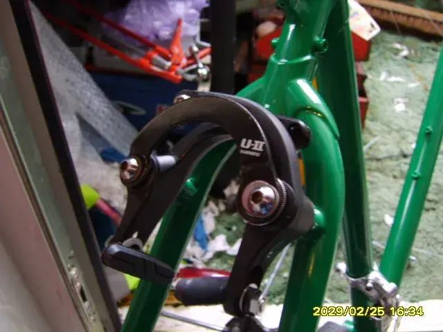

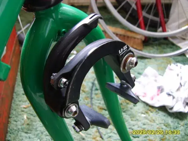

Hi guys ,
Had a few mins spare today so started assembling my next project , I has Deore XT 'U' Brakes front and rear, trouble is its been that long since I used this type of brake , I have forgot where all the pieces go and how the cable routing goes.. :? :? :roll: :wink: anyone got any sketches or diagrams on assembly and setup. please.. :)

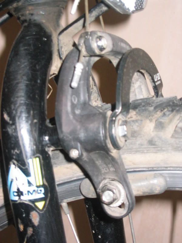

leave them with the blocks as far away from the rim as possible (but equal both sides) and tighten them up, that will give the tension .

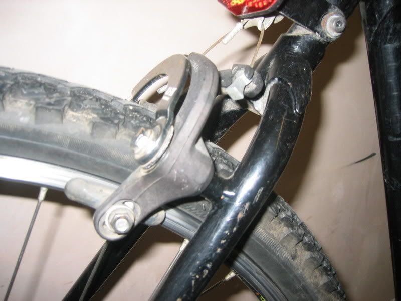

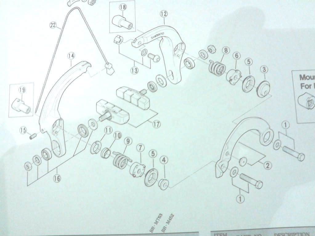

heres mine ➡️
Thanks for the pics :) really helpfull,... do the spacers and bits have a specific order of assembly ? think I have set mine right ?
