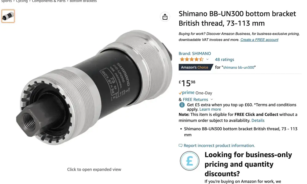

Help needed please šŸ™ Will this BB fit a 94 Zaskar??
Standard British threading, 113 mm total spindle width for a bottom bracket housing width of 73 mm. All very standardized.
Your Zaskar, you need to measure what the bb housing width is. Iirc it's 73. If the width turns out to be 68 mm you will need a shim for that bb there in your photo. While you're on amazon buy some digital calipers! ;)
Thank you, the width is correct but wasnt sure about the british thread.
