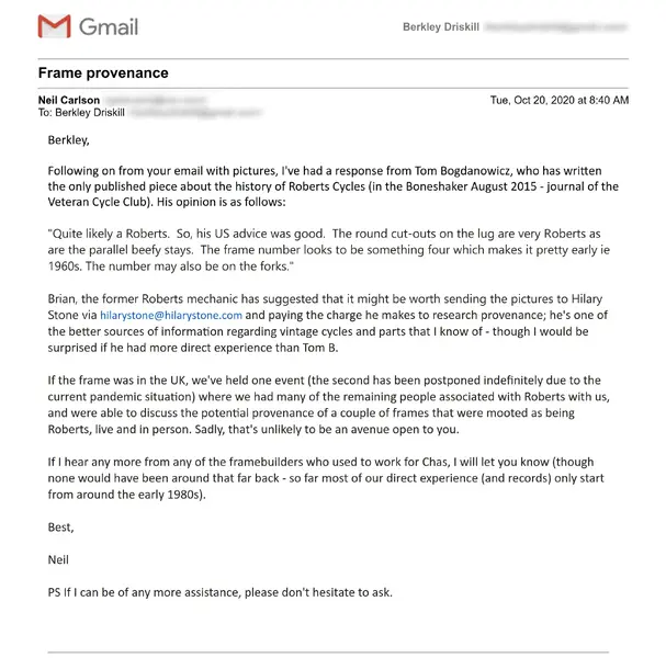

Wow! Thanks for the info. No, I have not discussed anything with Geoff Roberts. I had considered it but felt confident with the contacts I had already made. Just to be safe, I will make an additional attempt to get confirmation on the frame from Geoff, or a representative from Geoff Roberts frames. Attached are 2 of the emails received from those answering emails at http://www.robertscycles.com.
The 3 people who reviewed my frame were:
1. Tom Bogdanowicz, who has written the only published piece about the history of Roberts Cycles (in the Boneshaker August 2015 - journal of the Veteran Cycle Club)
2. Brian Phillips - former Roberts mechanic
3. Neil Carlson (website author) http://www.robertscycles.com.
Thanks again for the feedback!
-Berkley
