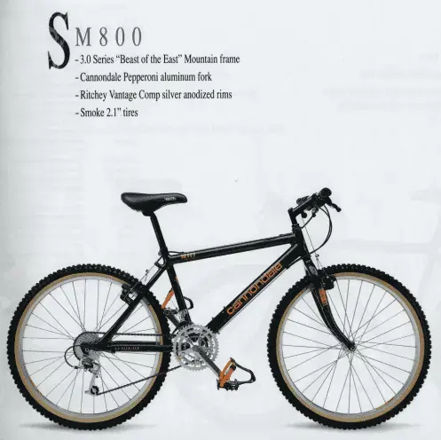

I think it's a standard geometry frame and not the Beast Of The East frame, which has a longer headtube and a sloping toptube.
I think "24pouces" was right. I thought alle bote frames had the longer headtube, even the small sizes, but this screenshot of the 1991 catalogue shows a short headtube.
:D
I only got small sized old 'dales. How to recognize a small sized top level frame to a BoTE ?
Look at the jonction between seats stays-seat tube and top tube : on 15" size, the seat stays are weld under the top tube (like Rocky Mountain…)
