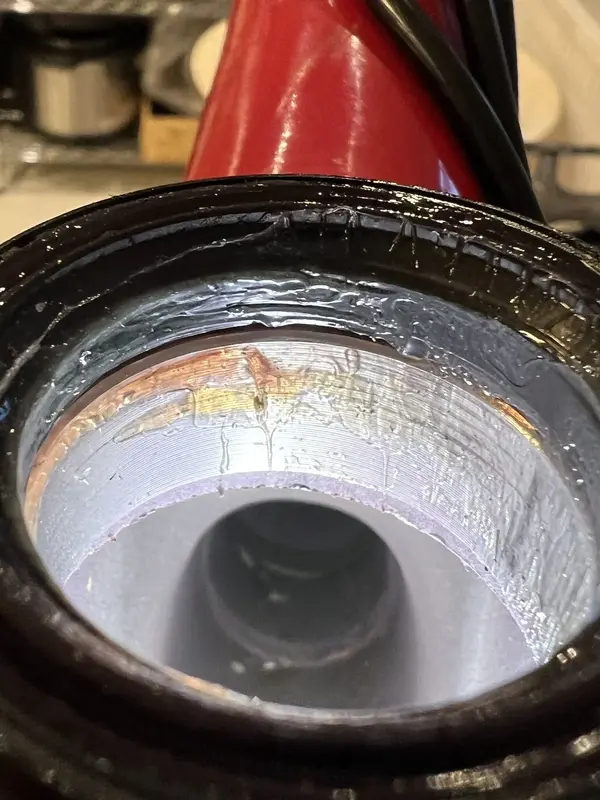

Here's a weird picture I manaed to take through the steerer tube, into the top tube. You can see where the tubes are joined.
I don't see any carbon in there, just this monocoque alloy all the way throughout the bike.

Fear not, that is not an alloy frame.
It is definitely carbon.
Just uses aluminium sleeves at all the interfaces with other parts.
Can you expand on that? Why do you think that?
I posted pictures of the tubing from inside. I've never had a carbon bike, so I don't know what I'm looking for, but the minor chips all around the bike show alloy underneath.
I think he's suggesting the same as me earlier. Basically there are often alloy tubes or insets in carbon frames where added strength is needed. Areas such as head tube (you don't want to split that nice carbon fitting a headset), bottom bracket shell (not sure it's a good idea to thread carbon in such a high load area) and seatpost (added strength for the leverage a post can put through a frame, even steel or alloy frames can crack here). Then there the drop outs, often alloy bonded into the carbon.
Yes there are hydro-formed alloy frames, but even these seem to have welds somewhere. Your frame has no welds anywhere that I can see.
I'd guess it's a carbon frame. The way I'd say is easiest and least invasive is to simply flick the main tubes with your fingers. Carbon would sound dull and dead, metal would ping.
