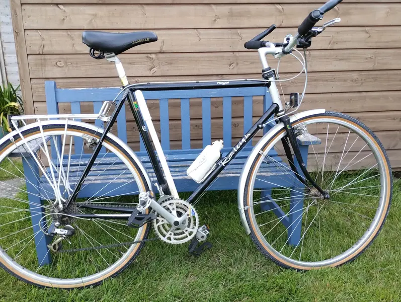

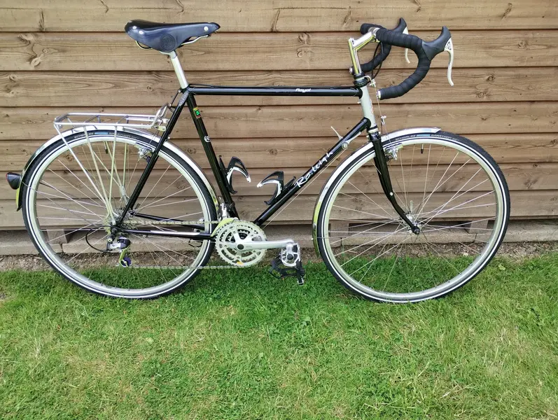

Second-hand Dawes Galaxy with knobbly tyres? Such a bike could take you round the world on road, trail and loose stuff (I ain't saying 'gravel'!). How much of this bikepacking malarkey will need genuine mountain-bike capabilities? I can't imagine a lot of pedalling will be done on really rough/ steep stuff fully laden with tents, clothes, food and kitchen sinks. Rather, you'll be pushing.
Are you seeking the wrong bike? Yeah a 90's MTB will be cool and whatnot but you might not find front forks with all the braze-ons you need if as mentioned earlier you're looking to use front low-rider pannier racks. They're generally a bit stretched-out. Do-able of course, but I'd say you must start with the right frame. For the mileage I'd be more content on a tourer with knobblies.
