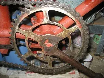

Lets concentrate on the chainwheel and cranks?

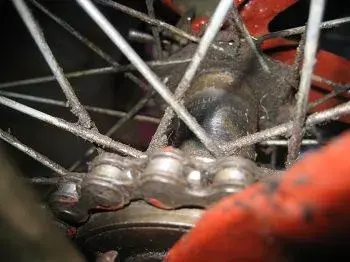

Ray, I would like a look at the hubs, showing the spoking. The wheels look to me like a small shop rebuild. Also the chainwheel and crank area.

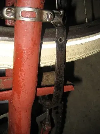

I should be able to get these photo's up this evening (Fingers crossed) I'll also put in a picture of the rear brake assembly as I don't know what a single side assembly is. The only reference I have been able to find was on a bike with wire brakes as opposed to the rod brakes my bike has.

I looked at Brown Bros catalogue, and oddly most of the rod brakes had the rear brake rod down the left side, whereas yours is on the right, as most bikes were.
The brake rod rear on the wrong side could just be where I reassembled the bike after cleaning it. On Monday I'll see if the brakes will work with the rods on the other side. the frame does look like the brake rods can go on either side as the pivot has a curve "washer" to hold it flat to the frame. Here are the requested photo's of the spokes, chainwheel and for good measure one of the rear brake assembly.
