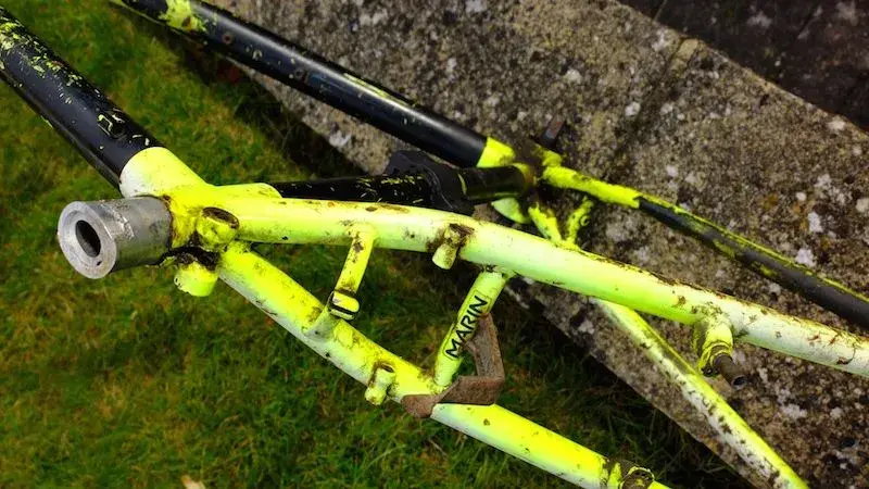

Hello, I recently was given a Marin mountain bike frame with a stuck Seatpost. I was told it was from 1992, but not sure. I have had a look at several things on here but cannot seem too de-code the frame number, it is M02ISO601. Your help would be much appreciated.

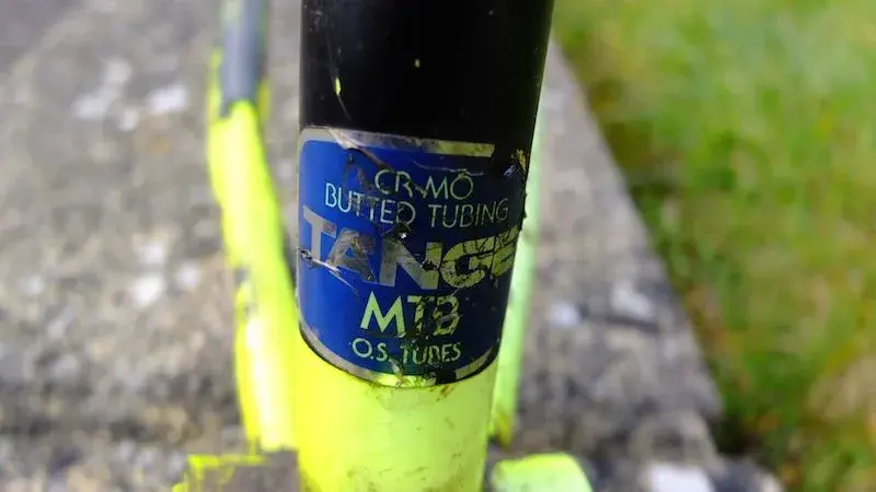

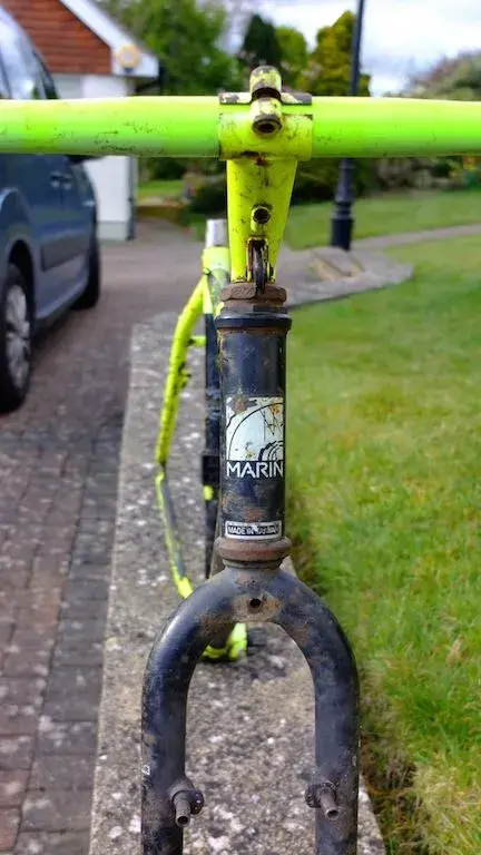

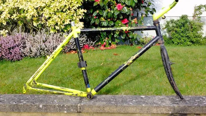

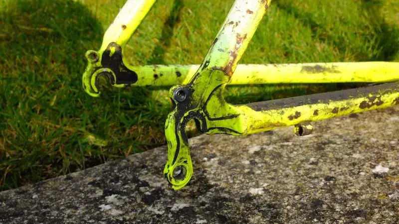

A 1992 Team Marin?
Here are the pics!
The frame is day glo green (like Team Marin in 1992 catalouge), not yellow as the pictures show.

Looks like a 1992 Muirwoods to me.
Edit: Just noticed you say not yellow - Palisades then?
Think the tubing sticker would say Prestige if it was a Team? Catalogue mentions external ribbing on the down tube too on the team - worth a check.

Possibly, but the down tube has a diameter of 37.5, in the catalougue it says 35mm down tube for Palisades and Muirwoods?
