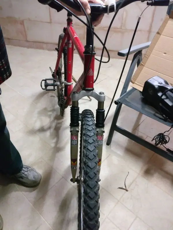

Raging_Bulls":qq5uq7ih said:
The Mag21 forks may only need a good clean and a service with new seals, but you'll need special tools for it (at least according to the service manual).
Thanks to the service manual we've managed to fix it! Thank you!
This is how it looks after a good clean, replacement of the oil (there was very little left and it was very much done) and pumping air into it.
We've also spray painted the bridge and removed a bit of the rust from the screws:

Good work. Lovely to see an old bike with sentimental attachment having new life breathed into it.
The collective knowledge on these boards is astonishing. Glad you could access it and find wha you needed. Watch out or the retrobug will bite you!
