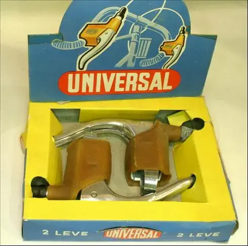

Also some Universal 61 levers to go with, they are suposed to look like the picture below, but unfortunatly don't have the gum hoods anymore.
Not sure if anyone on here has any replacement hoods, but I found these for sale on the Italian e-bay;
Universal hoods
Universal hoods
I'm still digging away in the garage. I unearthed a brand new, boxed chain and two new 5 speed cassettes the other day. I did find a small bag containing a single centre pull cable clip. The clip is branded Wienmann but I don't know what version he might have had. I do have the levers but the rubber shrouds have perished.
