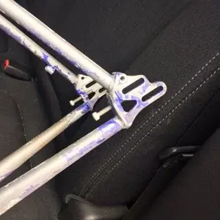

Help identify this Voodoo Frame
TheBladeNo9
This pic is all i have to go off of besides the Headbadge and voodoo stamped on the back
I'm not sure - but what else could that sticker be?
There isn't a lot of Voodoo information on the web, but a bit of poking around suggests that the Wazoo was Reynolds 853 with conventional dropouts in 2005, then used sliding dropouts and True Temper tubing by 2007. Your sticker looks like the later model.
Here's a geometry chart from 2007:
https://web.archive.org/web/20070716083 ... zoogeo.htm
So Jim is the wazoo a mountain bike model or a road bike, the frame is in sweet condition, i'm currently cleaning it with glass beads. Just trying to can a handle on what to start on...
When yours was built, it was a cyclocross bike - a 700c bike intended for short-course racing on mud, dirt and grass. These days they seem to be using the name for a fat bike.
I doubt that I could, but perhaps somebody could. Pictures of the dropouts might help narrow down the date range: that seems to be the major difference from year to year.
