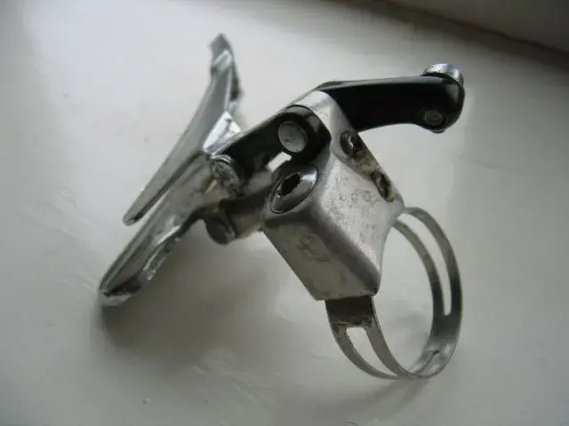

This is the kind of front mech you're looking for, this came off an early Fisher and will be needed for my RC100 I'm afraid

Sjscycles have a bunch of bandless mechs, not sure if they will have the right combination of size and pull though.
Thinking about it, would toons idea of using those desperado shims ( or Gil_m's far superior ones) enable a wider choice of possibilities as you'd then only be looking for a metric ID and OD rather than a metric OD and imperial ID bearing?

I have that exact Mech and band so the mech isn't the problem its the band which is round for one and diameter wise wont fit around the square tube. So either needle in a hay stack find a band off an original RC100 or get one made..........so does anyone know where I can get one made???
