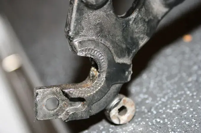

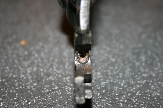

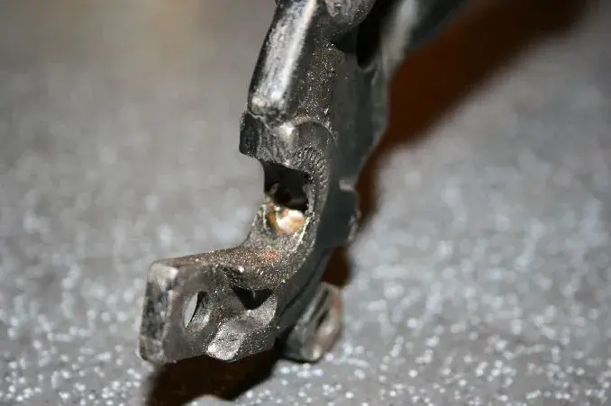

2) I've got a 1992 Karakoram - owned since birth. I've stripped it to the frame ready for a paint job but noticed a little 'issue' with the mech side rear dropout. there's a single hairline crack where the dropout adjuster screw goes. what should i do? bikefix in london said £100 to replace the dropouts which isn't feasible. Given it's a steel frame will it be fine and i'm being paranoid?
Could i get it repaired with a bit of spot welding etc? Know anyone good in London?
See pics of the Karakoram problem

What is the purpose of that hole in the dropout? It seems like a dumb place to drill a hole, but I suppose it's there for a reason... :?
Lawbags":2ynom684 said:
Depends how confident the welder is!
Ive welded head tubes back on loads of times and ridden them.
can you advise how you'd approach a weld here? Be useful to brief my welder of choice.
it held a screw as an adjustable dropout. all the early GTs had them. in hindsight it is a ridiculous place to drill a hole.
