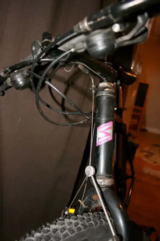

Brakes are V's now so will only work with V's not with your canti. Standard headset is 1 1/8 not 1 which yours looks.

Oh and A-head tends to be standard as well

Yeah, aheadset assemblies are lighter I suppose, but I much prefer the quill system yours has, as you have height adjust, aheadset sucks if you need more height. Also you have the front cable hanger stop high up, the best place, unlike later cycles, where it is too low down.

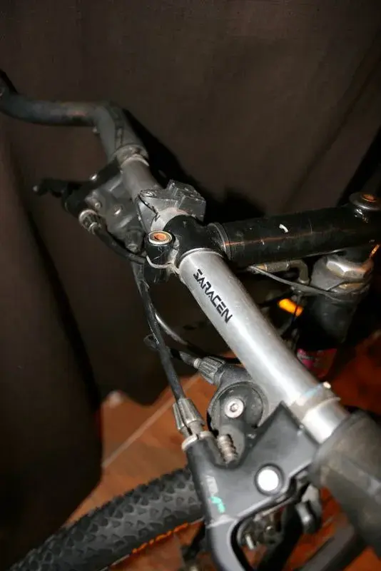

Edited to add, after another look at your pics, I notice you have an unusual collection of components on your bike, some old, the handlebar having the old style logo on them, that stem, I have never seen one like that before, and it complements the Saracen pierced top tube, could you tell me if that stem has Saracen stamped into the end of it ?
Other things, as another mentioned what looks like a one inch headset, ( mine was one and an eight XT) and the front brake cable routing seem a bit better thought out than what mine had. The other thing I thought odd, was the Altus brake/shifers on your bike, they I think came later in '92, as the ',92 bikes I knew of had XT, DX, LX and the stuff beneath that, my '93 Saracen had Altus when I got it. It seems to me your bike is a mixture of old and new parts, pre 92 and post or at least late 92, perhaps why it is a special edition.

Interesting to hear about the mixture of parts - yes the stem has the saracen logo imprinted. This explains why at the time all the Saracens I looked at in Halfords and those my mates had were all similar, but never quite felt the same as this one.

Then I believe you a rare stem with that logo impressed on the back, for I have never seen one of those, and I was, and am now a Saracen lover. In '92, the bikes generally had Zoom stems and Kalloy bars.
