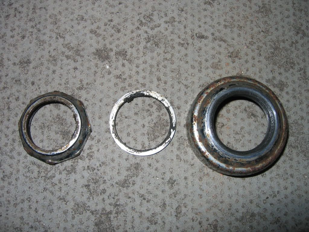

The headset in this Courier is the original threaded item and is very stiff and obviously needs replacing (plus I need to get it out to have the frame powder coated). I've removed the top locking nut (it took a bit of persuasion but eventually budged), then there was a spacer, then this odd looking horrendously corroded round ring thing:
All three bits:

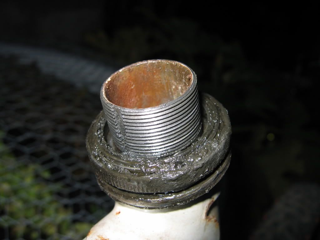

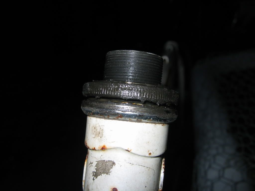

This then left this on the steerer - it looks like it has coiled metal inside it.
By this point it had gone dark, so I've given up for tonight. But just wondering what I do next... does this ring unscrew as well and then should the forks drop out (ahem!) :?:

If anyone's interested (judging by the mountain of responses, obviously not!! :D), the bit left on the steerer did indeed contain a coil of metal that gripped the steerer itself. Tightening the metal ring tightened the coil on the steerer. Very odd indeed.
Anyway, once that bit unscrewed, the forks dropped out easily. All it now leaves is the headset cups on the head tube and the crown race on the forks... avidly reading Google on how to remove those...
