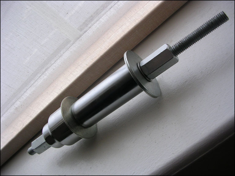

My home made headset press utilises a few strategically selected socket wrenches along with the threaded bar, nuts and big washers.
It works very well indeed.
Glad to hear it :wink:
Cheers Al. The threaded bar, nuts and washers you gave me have been modified into this:
The additional socket wrench in the centre fits the inside of 1 1/8ths headset cups perfectly and ensures that the cup goes square into the frame.
If I need to fit a 1" or 1 1/4" headset I can just use a different sized socket for the central sleeve.
I should've made one of these years ago.
sweet! what size socket?
