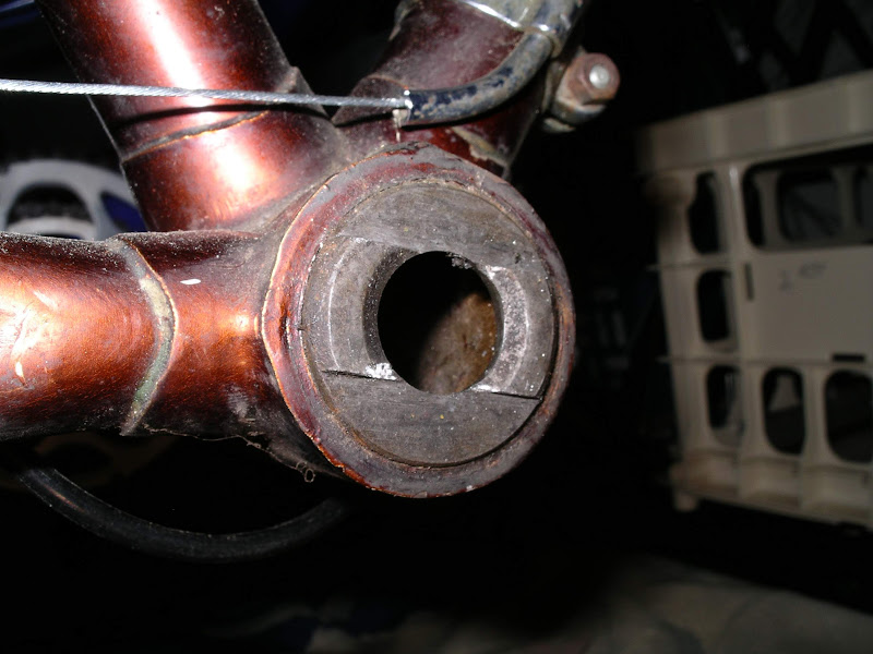

Yes, a bit at a time. I also haven't quite worked out how I can get the fixed side of the BB out either. Lacking on tools for this kind of thing just jumped in feet first!
Have you got a really good vice? Local bike shop can usually whip out the fixed cup for very little money,

The bottom bracket cup you indicate is Raleigh, I thought it looked like a Raleigh head set. Both will be 26 threads per inch, not the old standard 24.
The RH cup is Left Hand thread.

Thanks Keith, good to note. I had also read about making a tool from a bolt and washers to remove the fixed cup but I think I will go down the LBS route as no doubt they will whip it out in a jiffy.
I didn't realise this would involve so much reading and watching YouTube videos but it's all fun.
The LBS should have a tool like the one below that clamps onto the BB cup and then removed with the T-Bar. It has interchangable heads to fit various bottom brackets. The one in our bike shop BITD was a lot beefier than the one in the pic :D
