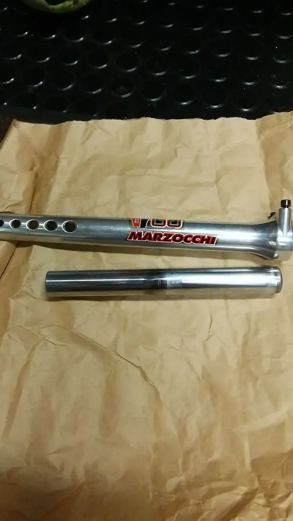

Update: Picture of the stanchion tube.
So my guess is: This is the same technique than XC50 / 51 (24mm) with a slightly modified design.
I was told, that in the past it has been serviced using a XC400 seal kit.
So all we have to change is the 24mm oild seal, the 24mm outer dust seal and the o-ring in the upper air cap.
As the fork is in use, we will not receive a picture from the inside parts.
