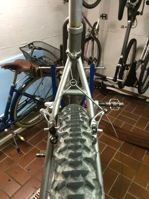

Have I set my brakes up wrong on my Kona ??
Thanks for all the replies....
Dog collar is original....
Have taken off the Onza chill pill
Raised the brakes one whole up
and works a little better but still looks weird from behind...
I had a plastic dog collar where it curvered around the frame so cable was straight but left it on the frame I sold as I prefered this metal one :facepalm:
Photos tomorrow of new setup.....
If anyone has a decent seat collar where the cable runs straight I am looking to buy one :lol:
This is exactly the same as my brothers cinder cone. Cantis don't need to be centred, you can adjust with spring tension in the cantis.
Thats the right collar,,as stated,make sure the brakes are on the maximum tension (top) hole,,lose all that plastic tube,too much friction.
the collar doesnt have to be centred,rotating it can make for a smoother run to the brakes..Chill pill is good (I prefer the Avid Tridangle),the hanger shouldnt be in the middle of the stradle cable,use the tension adjustment screw to set brake clearance..(higher tension on right side).
The lower your stradle cable (closer to tire),more powerfull brakes,but mushier feel at lever..
I think your real problem is that plastic tube,,it should be just to protect the paint on the top tube,cut at both ends and free floating..
Collar looks perfect. Front cable outer enters the stop at a funny angle; is there much friction at that point? Might just be the camera angle.
I'd be looking at cable friction TBH, including (as has been said) that length of plastic along the top tube. I also swear by Jagwire Slick cables the difference is ridiculous.
Whatever else you bodge with mismatched spring tensions, once you haul on that cable you're pulling everything over to the nds and twisting the rear wheel all out of shape. There's no way a brake can perform optimally with significantly more pressure being applied to one side of the rim.

Here is a photo of the setup now... works better but still not happy ....
I thought most Kona had dog collars and I can not see how they could have used such a bad setup?
Going to try with a set of Odessey Straddle this weekend to see if it helps... If not then it might have to be V brakes
Also a photo of the earlier plastic hanger where it aligns the cable in the middle
