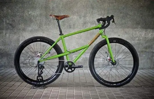

I’ve got to say I’m quite liking that, love the left had shifter for the dropper. And I’m really not a fan of the drop bar look.
The issue for me with fitting drop bars to an MTB would be the reach and stack. I'm quite short, but even for my height I think I have short arms, so frames with short top tubes and tall head tubes fit me best. Most 90s MTBs are the complete opposite of that - long and low.
On my 90s rigid MTB, even with flat bars, I swapped out the more typical 100mm+ stem for an 80mm stem and had several spacers underneath it to raise the bars to roughly the level of the saddle. Some of the bikes I've seen on this forum, have the bars 4 or 5 inches below the saddle, they might be OK for those of you with more gibbon like proportions, but would be instruments of torture for me - see any of Mike Muz's bikes. :D
On any bike with drops, the hoods are 50-60mm at least in front of the stem and so need one around 30-50mm shorter.
The reach issue is why I said that low-mid-range early 90s frames are best, as they are more upright. Try drops on a 1999 Kona Explosif and you are just about in the Superman position. :facepalm: :facepalm:
