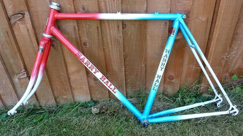

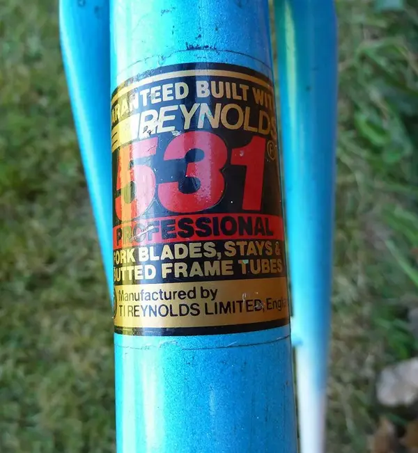

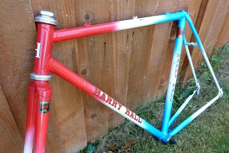

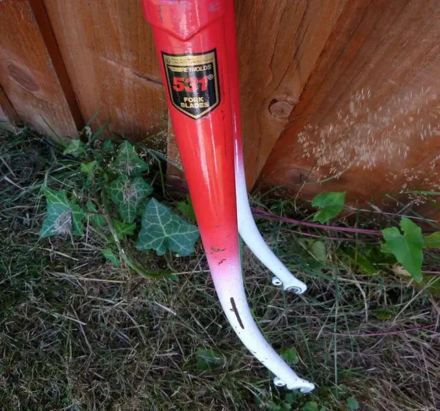

Hello. I bought this 531 Professional frame handbuilt by Harry Hall. As I could find out reynolds 531 Pro was used between 1982 and 1989 but I can not see any date or frame number to know a more precise building date. Can any one give more information?

Its never easy to date a Harry Hall precisely. Harry never built frames, they were supplied from various 'good' builders. The existing shop don't seem to have any interest in their heritage and without and components to help date, your 82/89 would be the best guess.
Harry did have an 'on site' builder for at least one period - Roger Kowalski. But this was earlier than the time of this frame. Roger later went and built Brian Rourke's frames.

Nice looking frame. From the design fashions (full length brake cable outer, tight fork bend, no shifter braze-on) I would think it's probably earlier in the 80's rather than later.
Thanks for your answers. It came with a shimano bottom bracket with the code LA which means January 1987 but i don't know whether it is original or not. Make sense?
Red 531 labels were introduced in 1982 and then the labels completely changed in 1989. So 1982-89 form the frame label.

That colour scheme is screaming 1988-89 to me, I'm thinking of the Graham Weigh frames in the back of Cycling Weekly - at the time, you couldn't buy anything else...
