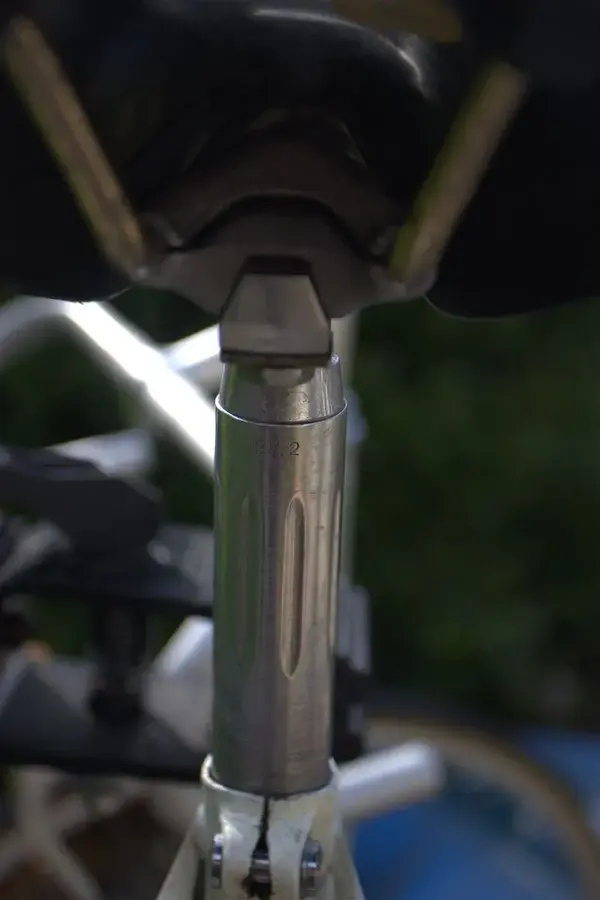

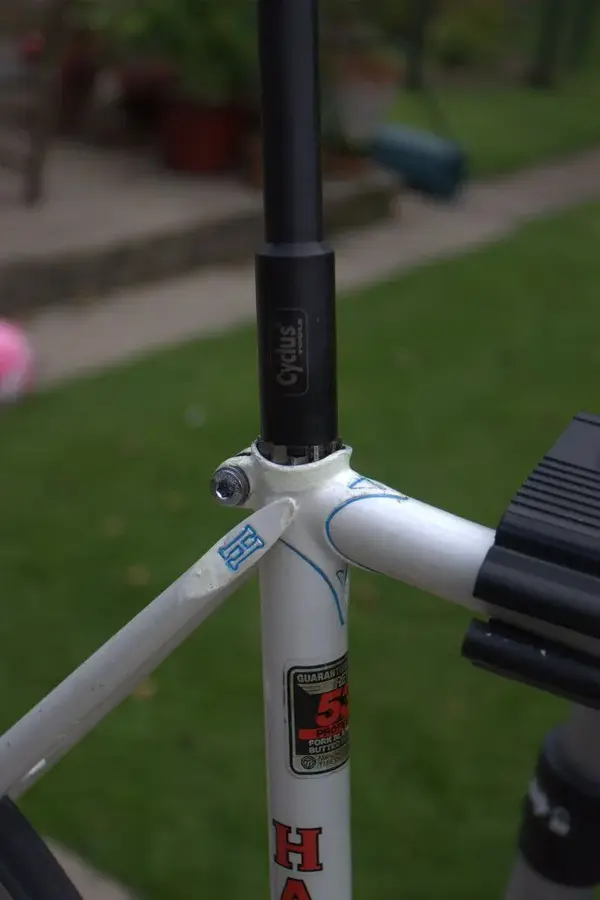

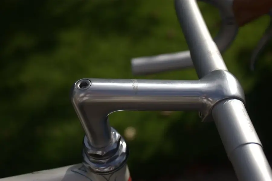

OK, some good progress today. I've added a seat tube reamer to my fast growing collection of Cyclus frame tools! Another great tool though, and being very careful it went in easily without any force and I'm sure it didn't take any material off the tube, only paint and rot from an old post that had probably been stuck inside at some point. It also cleaned up the top of the damaged lug that had been dragging on the post where it wasn't round. We now have a nice San Marco Rolls from 1985 on a Campag 27.2 mm seat post and a new Campag seat post binding bolt. Also picked up a modern Cinelli 1A stem and the new Giro d'Italia set of bars. The stem's fantastic like the old one but the bars are modern alloy, which is dull not shiny, but won't really show anyway.
More tomorrow hopefully - I'm waiting for some brake calipers and a bottom bracket.

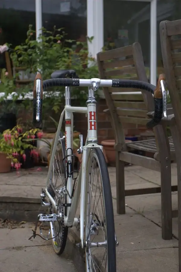

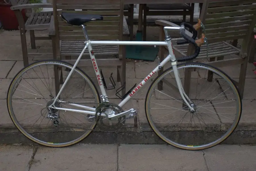

Coming on nicely now - not sure if the modern tyres and bar tape take too much away from the mid-Eighties look I wanted. Just the brakes to sort now really :D

Tyres and bar tape are consumables, bike looks ace :cool:

This is all around a plain but complete Shimano 600EX 6208 gruppo. I picked up some NOS brake levers with original gum hoods from JF Wilson's - aside why do we not see many of those here, they made beautiful bikes - the rest is low mileage, mid-eighties original, except the newer chain rings. A splash of Campag - Super Record seatpost and Record steel headset. I'm really pleased with the wheels, NOS Mavic MA2 on smooth 6208 hubs, I'm slowly becoming quite confident with the wheel building (next ones will be a disaster now I've said that).
This is getting to the point where it really deserves new paint :roll:
Re: Harry Hall 531 Professional
resist new paint, that can be done later if you really feel the need. Original is always best and bikes are for riding, not just for show :)
