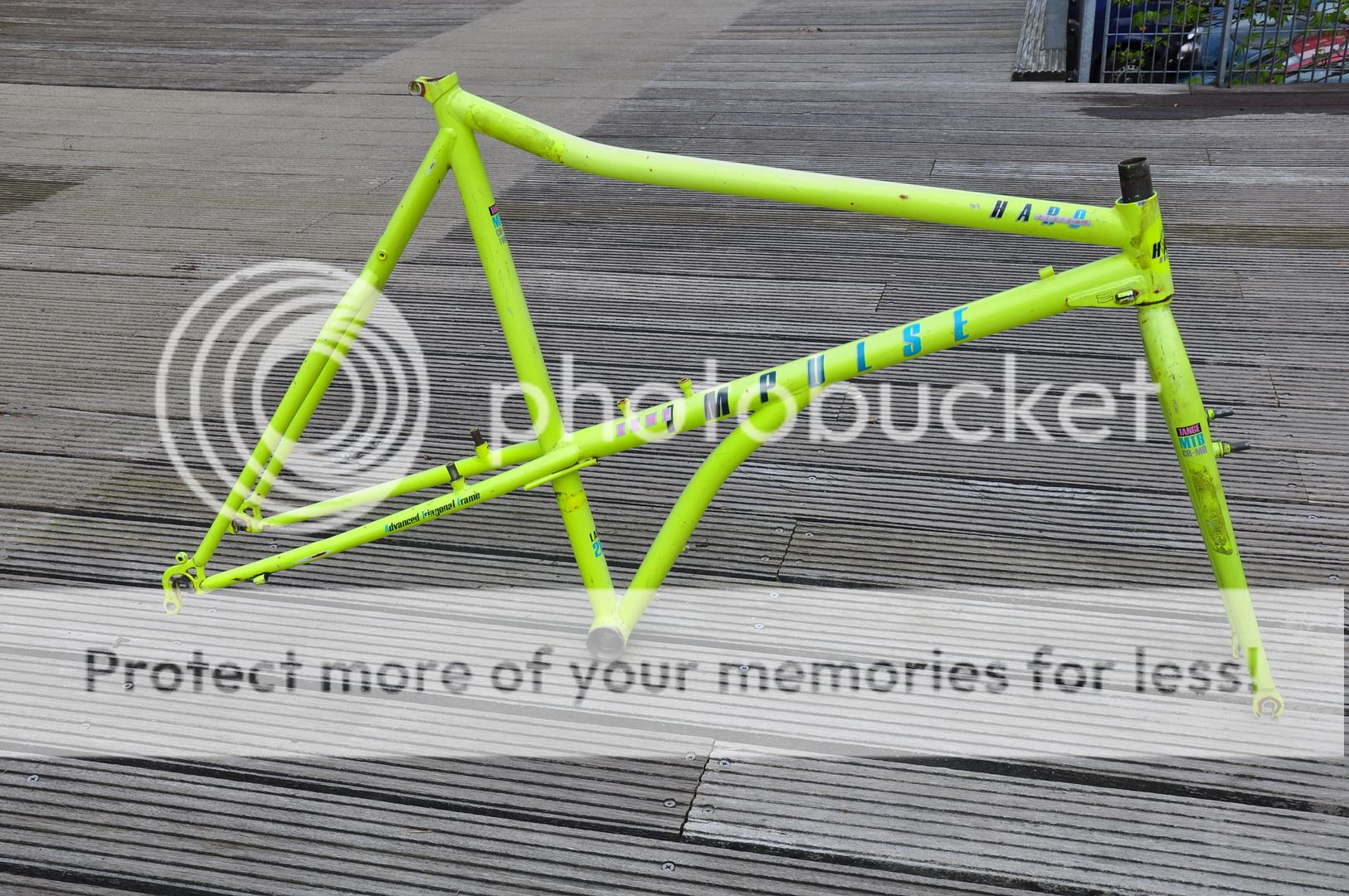

Here's my new project, a 1990 Impulse Comp. The paintwork is such that a respray, new decals etc. is required. For a while I wondered about rebuilding it as a higher spec extreme, but in the end decided to rebuild it close to the original spec ... I just like the idea of bringing it back to it's original condition.
Stripped down the frame...
All looks OK, so currently getting quotes for a respray (will keep the subtle neon yellow colour :-)). gil_m duly contacted, hopefully he can sort me out with some decals.
Bottom bracket was a pain ... bottom bracket lock rings were both plastic and completely trashed :facepalm:
In the end had to drill out the BB, it came away after some messing around. Unfortunately I was not as careful as I had thought with the drill on one side. Some of the threads were damaged :oops:
Thankfully the LBS sorted it out for 15 euro ... and drilled and re-tapped a couple of siezed bolts on the down tube at the same time ... phew ...

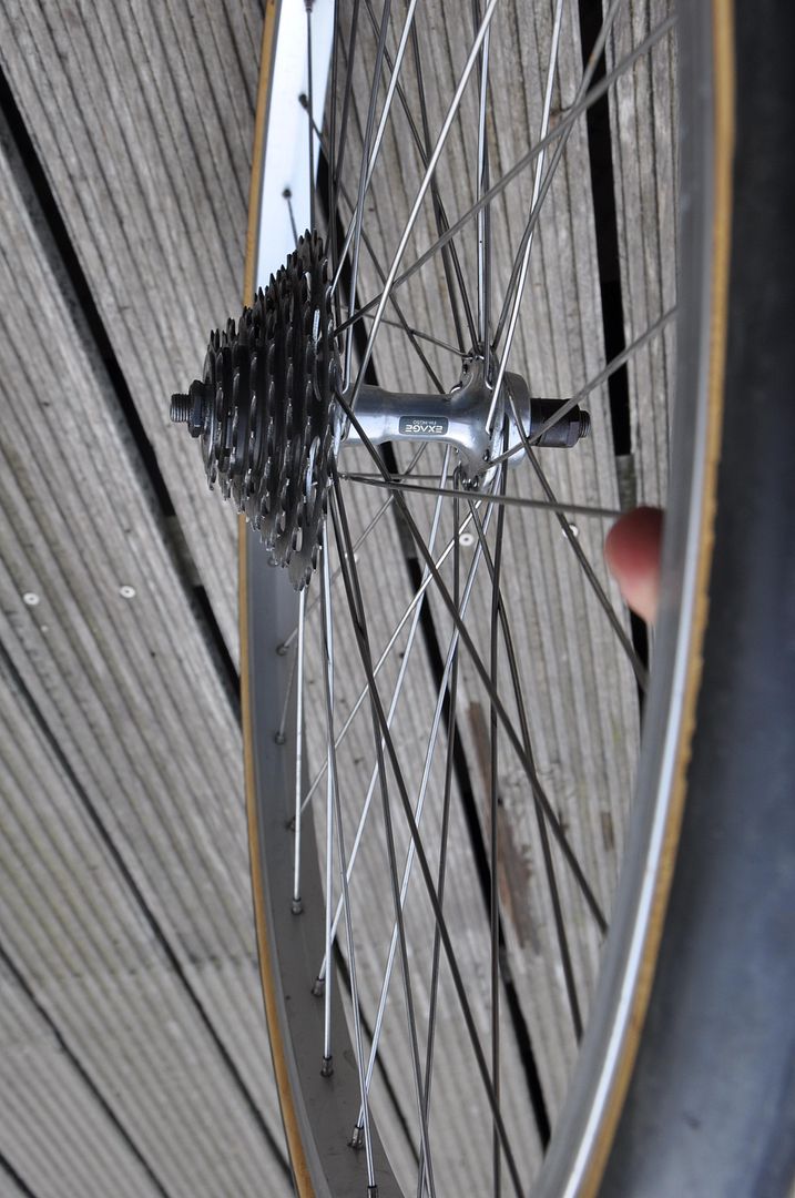

So, now having a complete kit, I started with (what I now realise) is my favourite bit ... slowly cleaning and making it all look nice again.
I started with the rear wheel over the weekend....
Not sure if the fat boys will stay on the bike in the end. But they look nice for now.

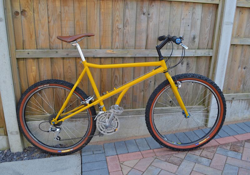

Cool, i used to have an extreme in yellow. Gil m quoted me £75 i think it was for graphics because he would of had to draw them from scratch, so i left the bike bare

The bike posted above cost me £20 believe it or not (plus the cost of a rattlecan repaint) so i couldnt bring myself to spend that much on stickers :lol:
Sean
Wow, looks great for 20 quid. So far I'm at 26 euro for the Haro and 30 euro for the donor bike (I'm not counting the bottom bracket "issue" :-)
