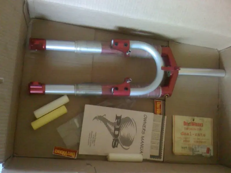

Just picked these up, did pay quite a bit, but have always loved them (the black ones were the best) loved their simplicity, and the ebay seller nicely lowered the value on the USPS to get passed having ot pay import duty,
No not quite, the black ones had the dial for changing the springs on top, and the crown jutted forward for better for rake (i think)

mattbrown: Can I ask how much you paid? I watch ebay for a PDS fairly regularly - what did he list it under? I need a pointer to help get one myself! :)

I paid just over 110 dollars for it, a bit steep but really wanted a pair, still after the black pair as i used ot own a pair. They came with springs as well as some elastomers.
The guy in America didnt list them for shipping abroad, but changed it when i asked, and recieved them bout 2 weeks later

I havent actually fitted them yet, might put them onto my 92 GT Karakoram, we'll see, the springs seem softer, than the elastomers, i remember the black ones had all different elastomers in them, i only have 2 now in each leg in these.
The pink was the softest (for the PDS - open cell poly) then white and
then yellow. There is also Light Blue and Red but I forget which is harder and I am too lazy to run down to the barn to check right now. :O)
The PDS usually came with 1 white and 1 yellow in it for ~140 pounds.
