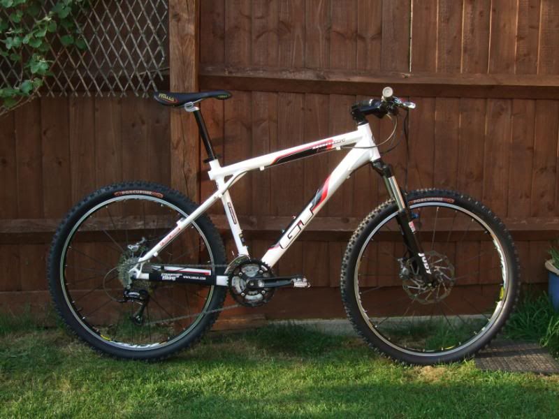

That looks awfully similar to my '05 Aggressor, caliper mount, drop out detail, everything......

What's the code under your bottom bracket casing Jimmy?
I suppose I could build it up as a rigid commuter?? :?
Any suggestions on groupset and forks?
Cheers you guys are leg ends :lol:
I did email GT but I have not heard back from them yet. I'm just not 100% sure what to do with it. Local powder coaters will do it for £15 so paint and build or sell on :?

Never did hear back from GT on this, and still have the frame in my shed.
Am contemplating building this up to have some fun on it, got my eye on a bike on evil bay at the mo that I could donor a few parts from.
Any advice what forks would be best on this, am a bit out the loop with modern sus forks? (don't have a huge budget tho :roll: )
80-100mm fork
this headset:
http://www.ebay.co.uk/itm/140616194773? ... 1497.l2649
31.8mm TP front mech
27.2 post (probably)
90mm stem
180/160mm discs
That's what I build my 04/05 Aggressor up with anyway! You could remove the rim brake mounts before getting it p/coated too... looks much cleaner. Nice ride too!
