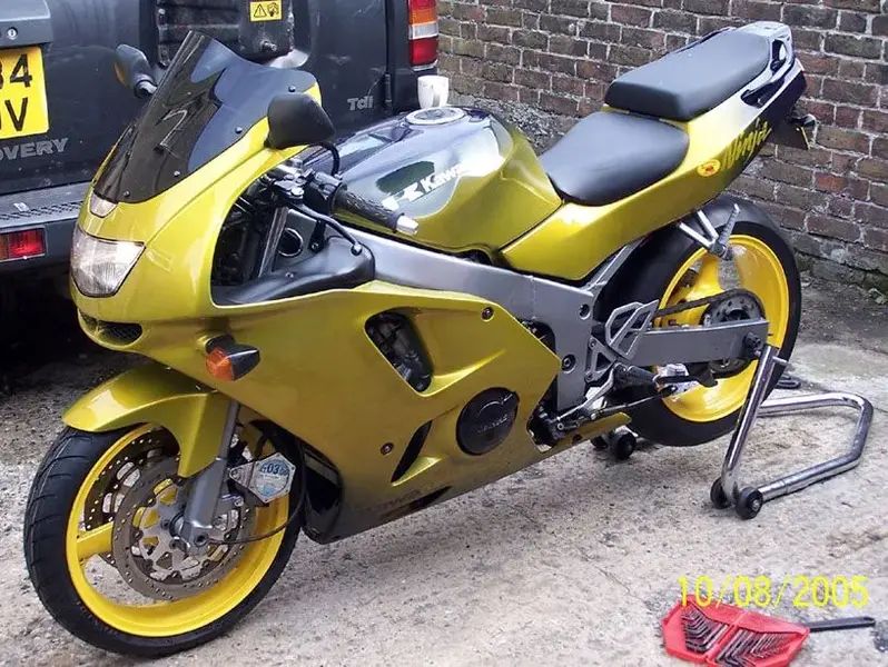

Did this to my Dads Motorbike last year for a bit of fun and its given me the confidence to do the push bike next :-)
