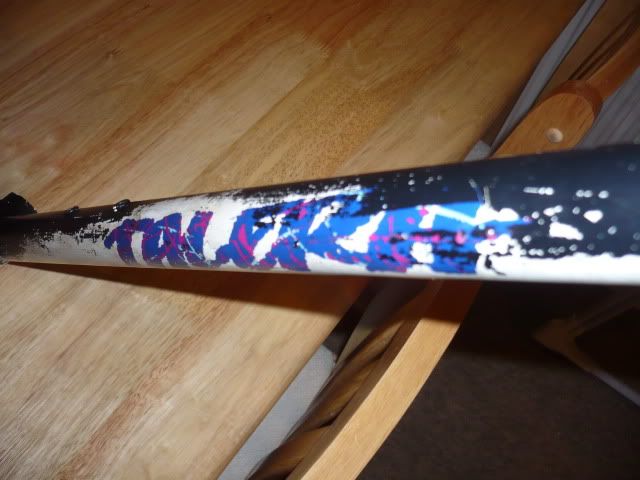

see if you can strip the black paint off. the original 91 92 era talera white and blue paintjob looks really good...
Yeah, the paint underneath the horrific matt black looks gnarly. But not sure how to try and strip it, white spirit is not budging but scraping with a knife just about works!
Anybody any ideas? Wet and dry perhaps?

In other good news, it looks like I might be able to save the original white paint! There are sections of the black stuff where the paint simply wipes off. Next stop, fine grade wet and dry...

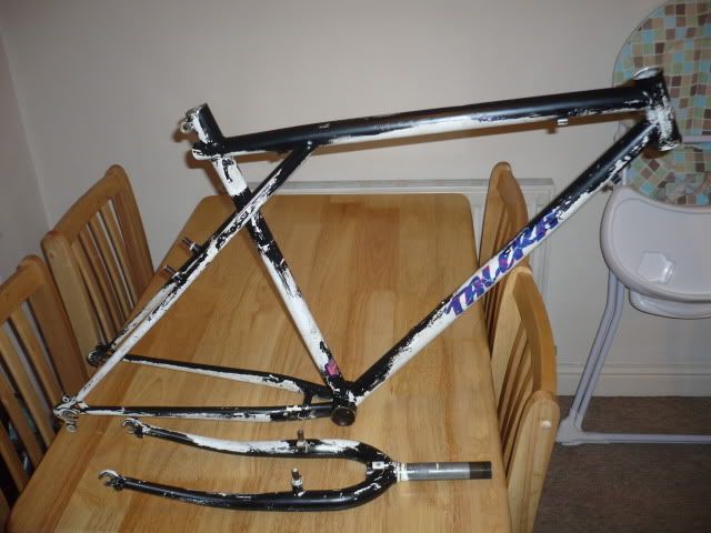

Well after a lot of hammering, unscrewing and general bashing (as well as reading up on bike servicing on this site!) the Talera is finally in bits and stripped back to the frame!!
As you can see, I made a healthy start on stripping the matt black spray paint off her. Alas, it seems that it was also taking the top coat of the original finish off too as the below (kind of) shows...
So, its off to the powdercoating place! Been quoted £20 for F and F (!) AND they run a trials bike business on the side so do loads of bike frames which means they should know what they are doing. You'll see the results here first!

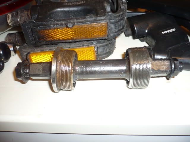

Now, I have two upcoming dilemmas. Firstly, the BB that was in the Talera is and old cup and cone type...
Should I service this and put it back in or just get a 'fit and forget' sealed unit? I like the romance of the old unit, but I imagine it is going to be a nightmare to service, refit and re-align? PRetty much answered my own question there, but opinions more than welcome!
