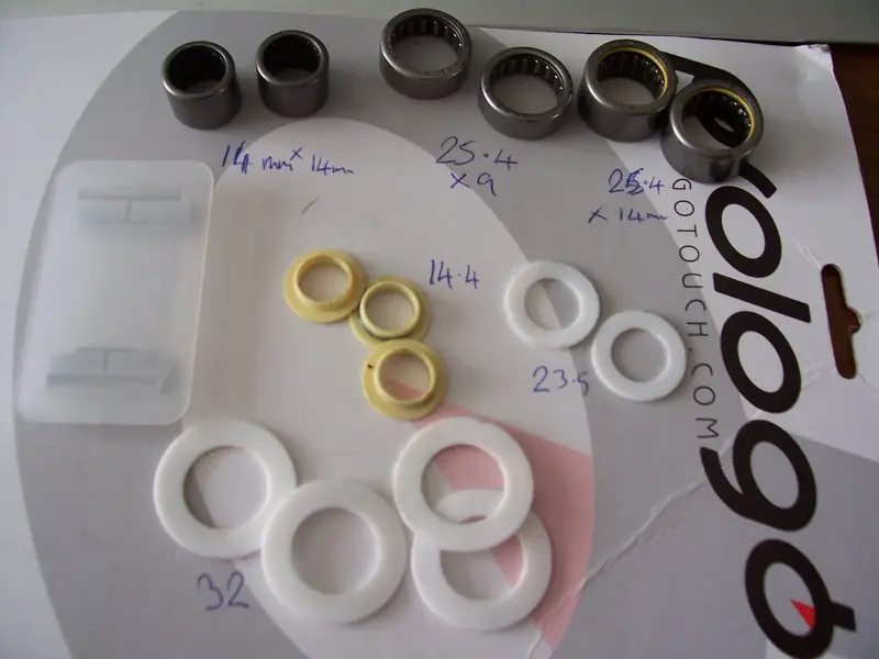

well i got my bag of bits today! and nothing fit except the trunion mounting chips! an expensive lesson. kit contains
4 nylon washers 32mm o.d 18.5 i.d nearly 2mm thick
2 nylon washers 24mm o.d 14mm i.d about 1mm thick
2 trunion chips
4 roller bearings 25mm o.d 20mm i.d 9mm wide and 2 at 14mm wide
2 roller bearings 18.5mm o.d 14mm i.d 14mm wide
4 washers to suit small roller bearings
these measurments are approx with a ruler. i will get a vernier later and get proper measurements.
if anything sound of use to anyone let me know. cheers guys
bearings
having just had a look at BETD gear again, it looks like some of the roller bearings will work with their bolts and spacers. doubt they will sell without the bearings but should be handy as spares for them.

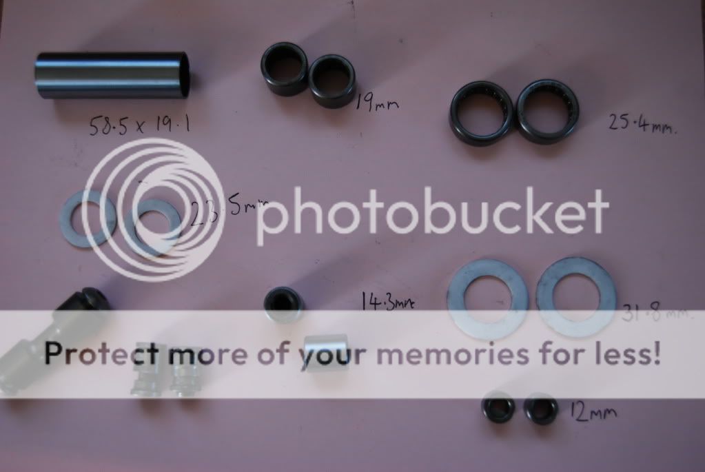

Here is what I have
There must be some place somewhere a manual or listing of all the LTS range through the years with the exact bushing and bearing sizes for each one? :?
