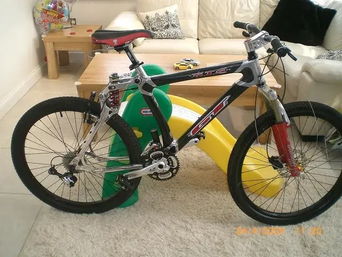

Hey thanks for the replies guys.
Here is a pic of my frame
The cable will exit out the frame at pivot just above the bottom bracket.
Nice frame, will make a really nice bike :wink:
Top swing, down pull, 31.8mm

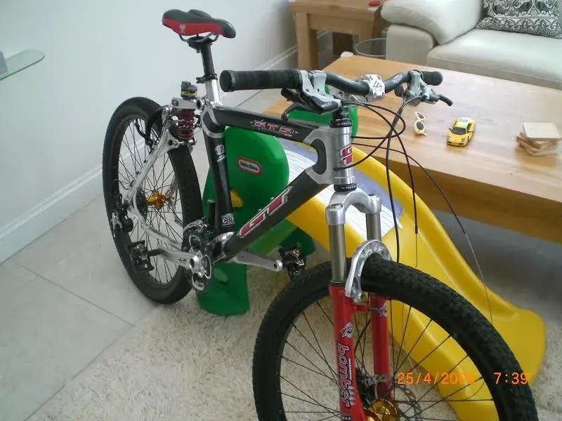

Gutted seeing it in someone else's house. I hope you put a rebuild thread up, nice to see what the full build will look like
Here's what it used to look like. :cry: :cry: :cry: :cry:
