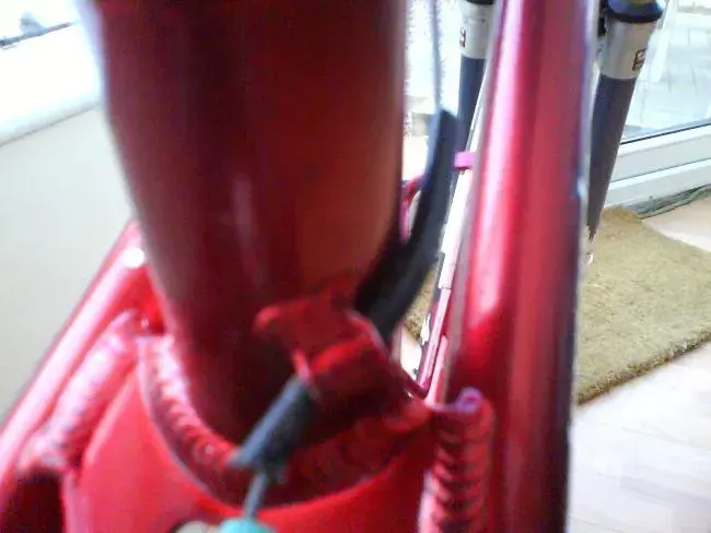

Is this of any help? The rear brake set up on Mrs GT's Backwoods.

Thats the set up on my Bravado
